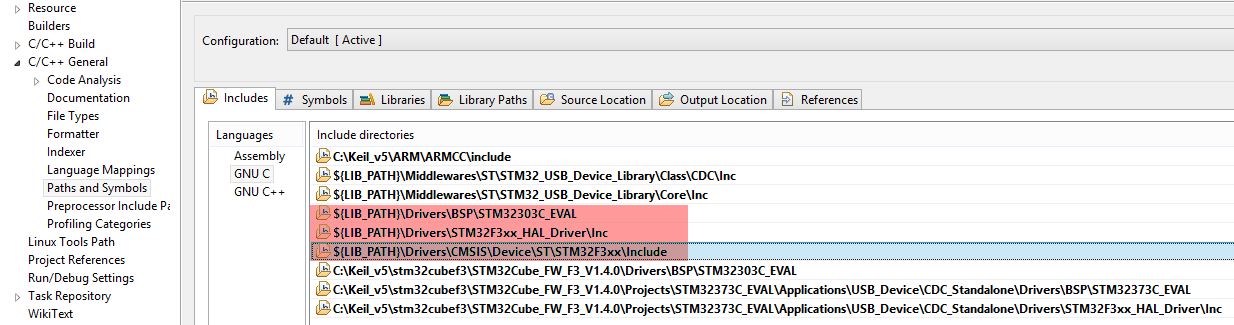

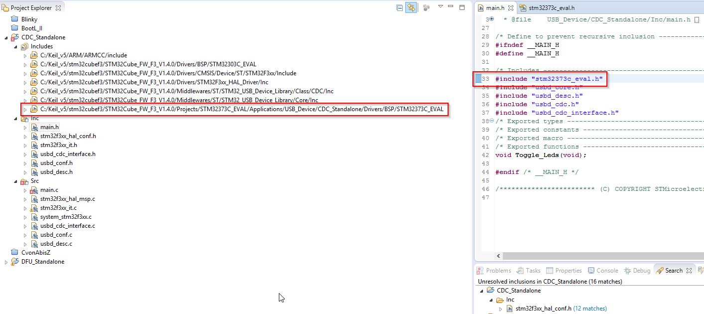

In the first pic you can see the state with the message
index.php/fa/25890/0/
Project Explorer->Includes Default means this include path is kind of deactivated just for this example, in the next pic it is active

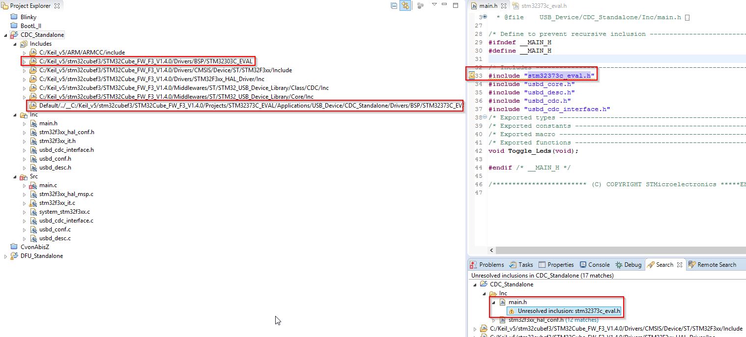

And in the second one without the message
index.php/fa/25891/0/
Whereas the folder "STM32303C_EVAL" contains the marked or unresolved header file

So therefore I give the directory which contains the headers as:
index.php/fa/25909/0/

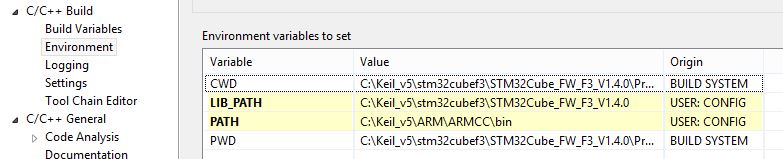

Whereas LIB_PATH means:
index.php/fa/25910/0/
So I set it under Project --> Properties --> C/C++ General --> Preprocessor and Symbols And this includes paths will appear under the Setting Entries "CDT Managed Build Settings Entries".

So according to your assumption it should work so far, - the headers are also there eclipse is not complaining about not existing folders which eclipse does if so. But in fact is not enough.
So I had to copy the folder "Drivers" to the following dir:
C:\Keil_v5\stm32cubef3\STM32Cube_FW_F3_V1.4.0\Projects\STM32373C_EVAL\Applications\USB_Device\CDC_Standalone\Drivers
this I meant is closer to the project.
After this the complaint about "unresolved inclusion" disappears.
