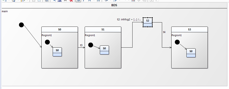

I have a State Machine, which has States. These States can have Regions inside. and Regions can have States and so on ...
The problem is that I can't resize States that do not have inner Regions, I can only resize States which have inner Regions.
e.g. in the attached example , I can resize S0, S1 and S3, but cannot resize S2, even though it shows points to resize on the figure.
index.php/fa/25869/0/
The States are Vertical Stacks and Regions are Free Form containers.
I can see in the UmlDesigner they have made it possible with some import stuffs I guess, but have no idea how they did it !

Until the compartment is empty it's normal that you can't resize it. The
compartment's size is calculated from the element in.
If you have one element in your compartment you can resize it.
Julien - Obeo

You might provide your own edit policy to handle the resize when there
is no compartiment.
The current resize implementation assumes that a RegionContainer with no
Region cannot be resized, it considers that it should have at least one
compartiment to be valid and resizable.
Could you open a bugzilla to track the issue ?

You could provide your own edit policy to override the default resize
behavior of RegionContainers for your mapping.
> I was wondering if there is an attribute, I just set it to true !!!!
> e.g. ep.SetResizable() ; !!!! editpart does not have such an attribute !
Here, the resize is combined between a RegionContainer and its Regions,
to synchronize the changes done on compartment, its parent and its
siblings for exmeple. This is not just an attribute as we validate the
change bounds request from the current diagram/model structure and
compute a composite command to resize the RegionContainer and all its
compartments.
