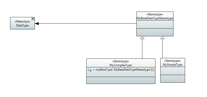

1) Created a profile whereby I have a extended DataType with some stereotypes for a "complex" and "simple" data type". The complex type can reference another type as its "base" type.

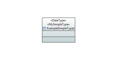

2) Created a model using this profile and defined a simple type in it (with the stereotype MySimpleType).

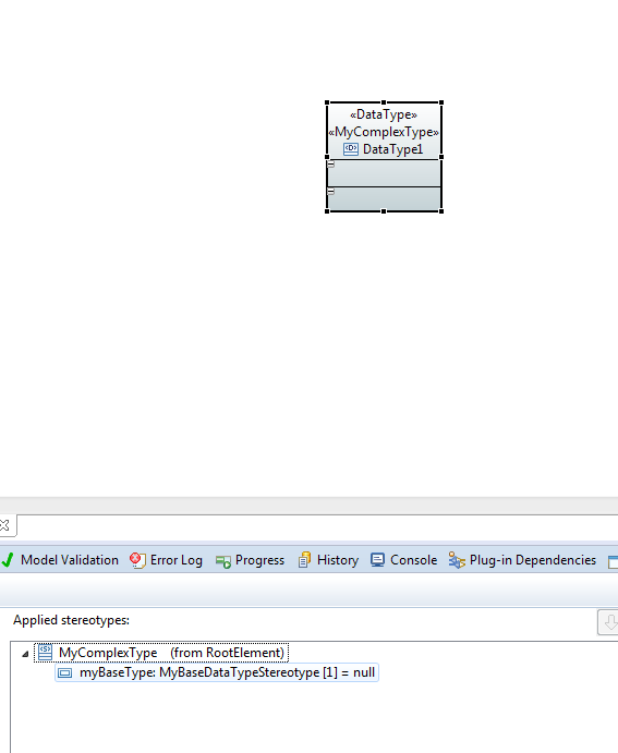

3) Created a second model and defined a complex type in it (with the stereotype MyComplexType). I've then imported the simple type from the first model (using a package import) and assigned this to the "myBaseType" stereotype property.
If I now update the profile and reapply it to the second model, the "myBaseType" property value is reset to null.
I can zip up the example (or stick it on GitHub) if that is helpful and raise a bug if appropriate?
Guidance again appreciated. Thanks.

Ah, okay, now I understand more. Your stereotype doesn't have a
reference to a model *element* as such, but rather to a *stereotype* of
that model element. You wouldn't have this problem if the reference
was to the UML element that is the base type.
The reason why this is happening is that the profile applications of
both models have to be updated together. If you update only the model
containing the MyComplexType, with the reference to the base-type in
the other model, then the new version of MyComplexType requires a
reference to some instance of the new version of
MyBaseDataTypeStereotype. But the simple-type in the referenced model
still has the old version of the MySimpleType stereotype applied, so
it's not an instance of the new MyBaseDataTypeStereotype and therefore
the current value would not be valid and the reference is cleared.
To work around this, as I said, you could make the
MyComplexType::myBaseType property have type UML::DataType instead of
MyBaseDataTypeStereotype. But I can see why you might not want to do
this, because only other complex- or simple-types should be allowed as
base types.
