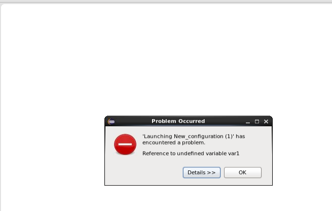

We have used Luna for a long time but wanted to check if we could use Mars edition.
Everything looked fine until we found out that we have to add all string substitution variables.
Example:
In our run configuration of our test suite we have the following vm argument:
-Ddata=${var1}
Then I press "Run" button.
Launching confiuration .... encountered a problem.
Reference to undefined variable 'var1'
What is the purpose of this validation? Is it not possible to turnoff this validation?
Our users of Eclipse thinks it is very confusing and we get a lot of questions about this. Any workarounds?
All input appreciated.
br,
//mikael

Re: Annoying string substitution validated when used as vm argument i run configuration [message #1731703 is a reply to message #1731683] Mon, 09 May 2016 07:43 Go to previous messageGo to next message
Yes it seems to be the issue so I we use:
-Ddata=$"{var1}"
It will not try to validate.
Do you know what is the purpose of this and which version of Eclipse it was introduced in?
br,
//mikael
