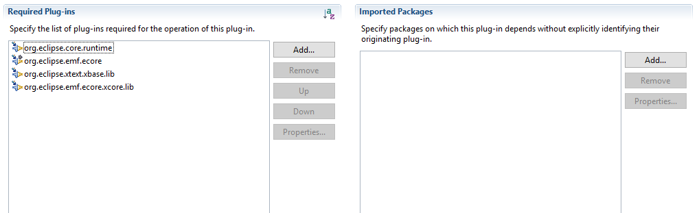

I have org.eclipse.emf.ecore in plugin dependencies of my.mydsl

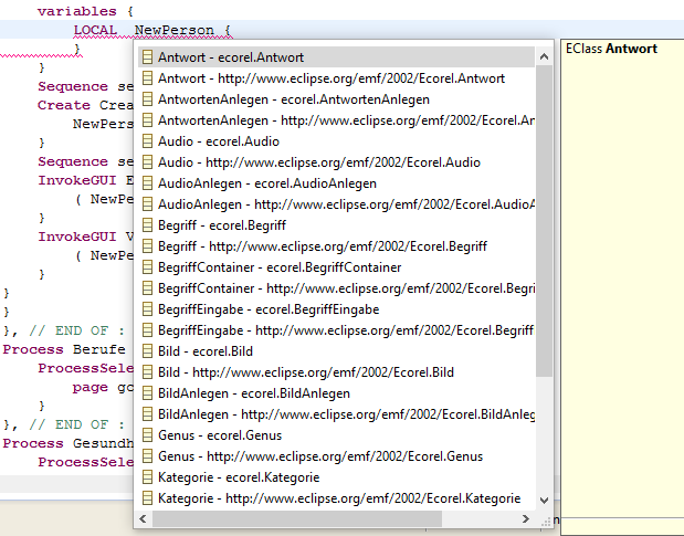

but when I want to use content assist I have all the classes that I have defined in another ecore file ( that 's what I wanted ) I need EString and EInt and .... ( but I don't have them)

Once again. Is the ecore file containing these on the class path. It is not
unless you actively put it there

hi, your models should reside inside a source folder - otherwhise classpath based scoping will no work correct
Re: Type for variable [message #1731638 is a reply to message #1731637] Sun, 08 May 2016 11:43 Go to previous messageGo to next message
YES,
Thanks a lot. That is exactly what I needed.
What's the difference between src folder and another folder?
Re: Type for variable [message #1731639 is a reply to message #1731638] Sun, 08 May 2016 11:50 Go to previous message
Xtext calculates what is visible in global scope differently
