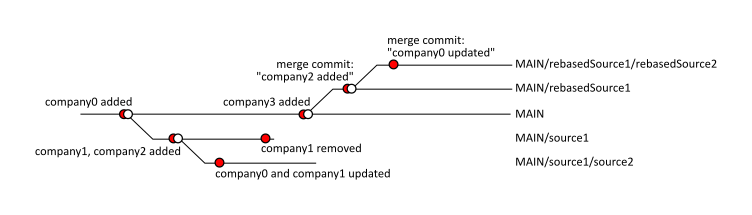

Greetings,
We encountered an interesting edge case when trying to merge changes from one branch to another, similar to git's rebase operation (red dots represent commits, white dots are branch creation points):
index.php/fa/25836/0/

This test throws ObjectNotFoundException when trying to commit merged changes on rebasedSource2 at the end. CDOTransactionImpl.applyChangedObjects(...) assumes that any CDORevisionDelta that appears in the change set can be acted upon, and tries to load company1, but it does not exist on rebasedSource1.

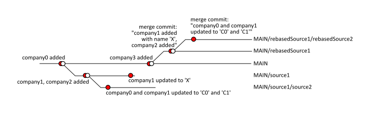

Another problem occurs when company1 is updated instead of getting removed:
index.php/fa/25837/0/

In this test, the last assertion fails; company1.getName() returns "X" instead of "C1".
If the branch base point of source2 is specified, the comparison for company1 ends up being a "CDORevision vs. CDORevisionDelta" case in DefaultCDOMerger, which the class does not handle currently, and the delta does not appear in the resulting change set.
If I leave out the base point parameter, the merge will arrive at a "CDORevision vs. CDORevision" comparison. I also have to override the default implementation of DefaultCDOMerger.addedInSourceAndTarget(...) to return the source revision in this case, but since rebasedSource1 already contains company1 (getObjectIfExists(id) returns a non-null value), CDOTransaction.applyNewChanges(...) will skip the new revision altogether, and the change set from source2 ends up getting partially applied this way as well.
