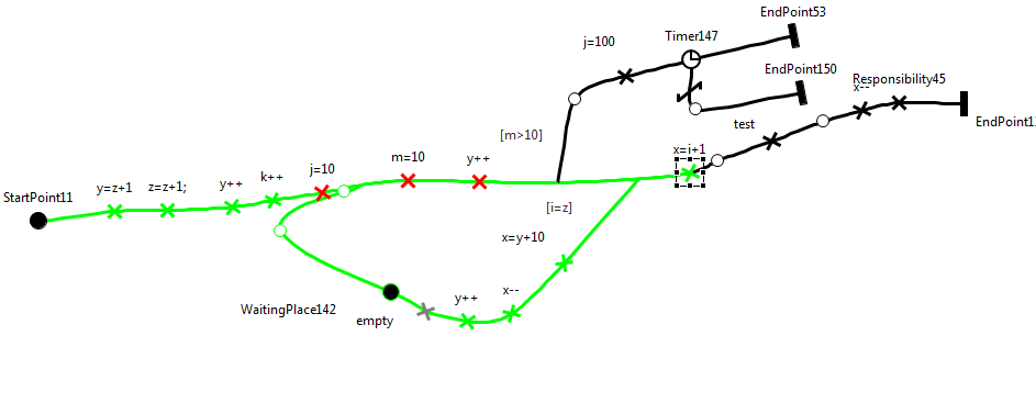

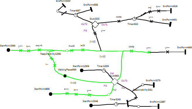

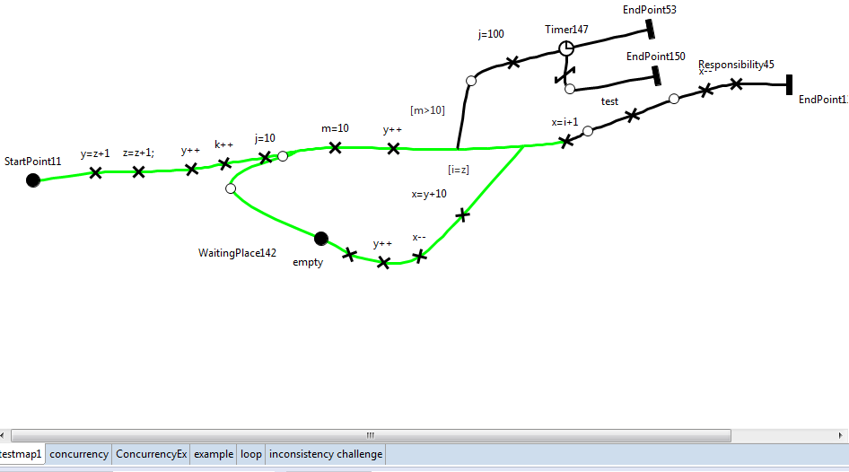

Attached two snapshots,one after executing my command which marks the the related paths with their model elements, and the other snapshot "TheIssue" is what i get when i just click on different page/edior and return to the previous one or just doing any edit on the editor.

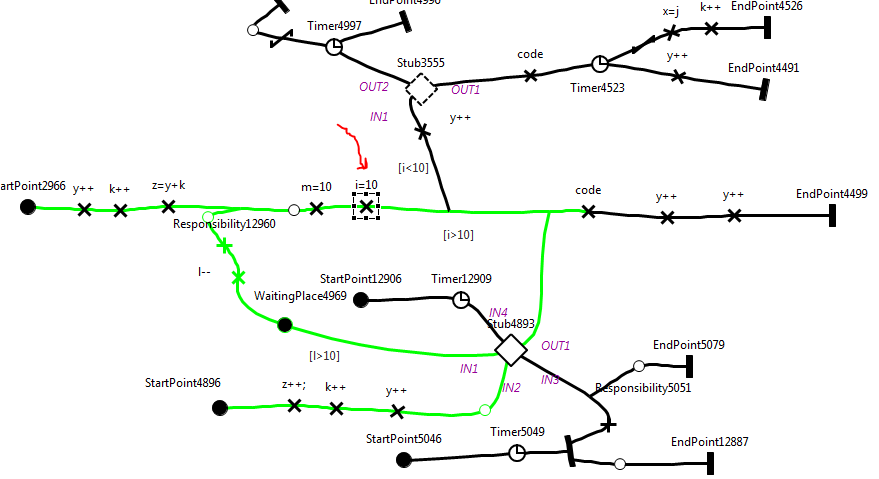

attached two snapshots, "beforeSelection" is when i execute my command is the my target
paths are colored with their objects. "Afterselection" snapshot you can see some objects(with x shape) are reset to black_ this happens when i click on these objects
if i do one simple change/edit on the editor, the objects are colored normally to green.
the issue is that when just click/deselect objects and not doing any editing, the objects are reset to black and never changed until an edit occurs.
-could it be some kind of select/deselect notifier that's called when selecting/deselecting objects? cuz i noticed that a rectangle appears bordering the target object once it is selected (it is shown in "AfterSelection" snapshot)
