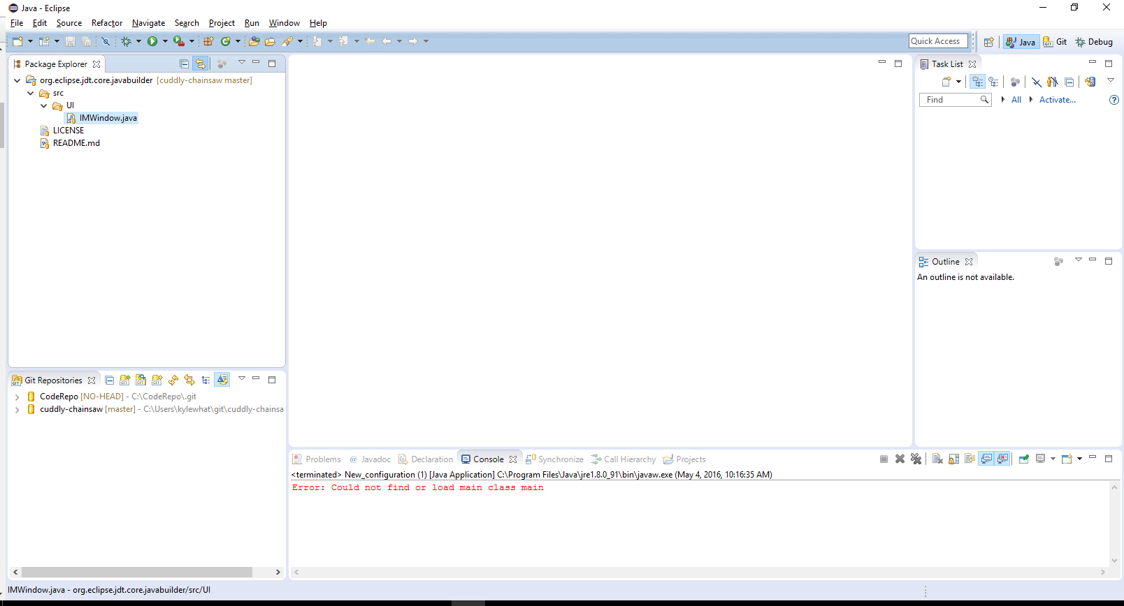

I am new to java & trying to learn with my friend. We created a sample on github and used egit to clone & then import.
It worked fine for him & he's able to run it as java with no configuration changes from a brand new install.
For me, it does not work because it just imports it as a general project no matter what. I have googled & searched for hours & hours but I can't figure out what is wrong.
Here is our sample on github: https://github.com/hayyyyyyyyyyy/cuddly-chainsaw
and I've attached a screenshot of my general project that will not run as java.
Also, I have re-created the project as a non-git offline java project and it works fine. Any help would be greatly appreciated.

The .project file you added has a strange name "org.eclipse.jdt.core.javabuilder" (it should be naming your project, which doesn't look like the JDT java builder)
and it's not a Java project, e.g. there is no javabuilder specified and you also lack the .classpath file needed to define the classpath for your project.
Best you create a fresh new Java project using the project wizard: click "New > Java Project" give it a name and then copy the resulting .project
and .classpath into your project. Note you can't open two projects with the same name in Eclipse so you have to delete the one you
used to generate a proper Java project before you can open the other one in the same workbench.

I created a new java project in eclipse & uploaded via the git shell, deleted it locally, then cloned/imported and it runs as java now ^_^
thanks again
