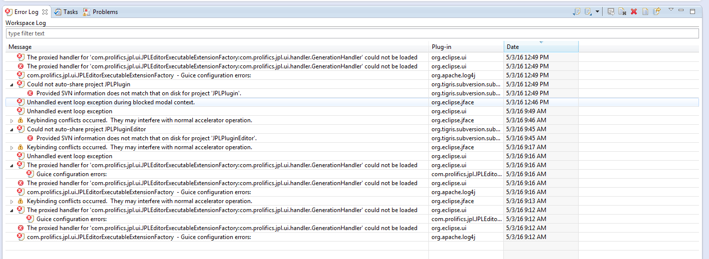

Hi Christian,
I am getting below error. Could you please tell me what would be the problem?
The proxied handler for 'com.prolifics.jpl.ui.JPLEditorExecutableExtensionFactory:com.prolifics.jpl.ui.handler.GenerationHandler' could not be loaded
PFA

Re: Xtext Proxy handler error [message #1731146 is a reply to message #1731144] Tue, 03 May 2016 03:58 Go to previous messageGo to next message
Do you get a trace if you klick on the error
Re: Xtext Proxy handler error [message #1731148 is a reply to message #1731146] Tue, 03 May 2016 04:10 Go to previous messageGo to next message
No I am not getting any response from that class.
