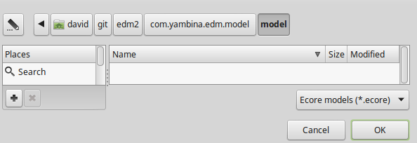

I start with running my CDO Server with an empty database. Using the CDO Explorer view I add my ecore file with "Package Registry... " Then I open a Transaction and create a new resource "resource1". Then I open in the CDO Editor and add a new model element. Once I Ctrl-S it crashed the CDOServer running.

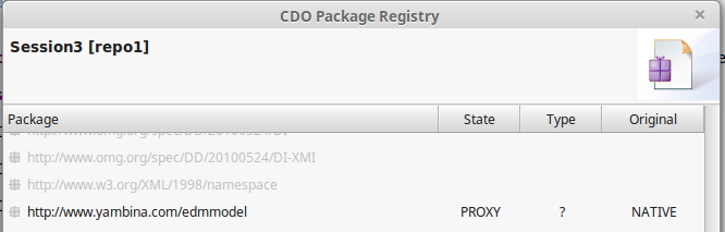

I must misunderstand something. I have a genmodel ready for CDO, but I describe the preparation of the database above, which has nothing to do with the generated code. When I use CDO Explorer view to open a session I cannot see my model as associated with the empty db. So I use Package Registry... to attached it, it shows as state == new, type = dynamic and original = dynamic. The I open a Transaction on that session, then I create a new resource, then I open that resource in the CDO editor then I add a model element, then I save and it crashes. How are you supposed to prepare a empty database ready to use with your client? None of the tutorials I could find seem to describe how you prepare a empty database ready for your model?
Can you be more specific w.r.t. the exact steps you take to register your package? If it results in a "dynamic" package,
you've probably done something wrong.

I was confused by something you said. As far as I know we do not use dynamic models. We generate code for the ecore file and use those generated classes. Was there something in the stack trace I posted that makes you think we use dynamic models?
I think you mentioned that the UI showed the package as "type = dynamic and original = dynamic".
