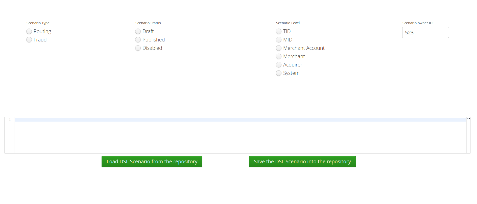

i have created a Vaadin UI application with integrated widget for DSL editing. This widget is the Xtext editor (implementation of the AbstractJavaScriptComponent).
My next step is to save text from Xtext editor into my repository and load text from repository into the editor. This functionality have to be implemented through DslRepository class which is responsible to store dsl's into the DB.
resourceId option will be created dynamically depending on which check boxes will be pressed.
I have just read documentation (http://www.eclipse.org/Xtext/documentation/330_web_support.html#getting-text-content) but don't clearly understand how to implement this functionality. How to delegate save and load functionality to DslRepository? I want to iplement this without JavaScript.
Thanks a lot!
