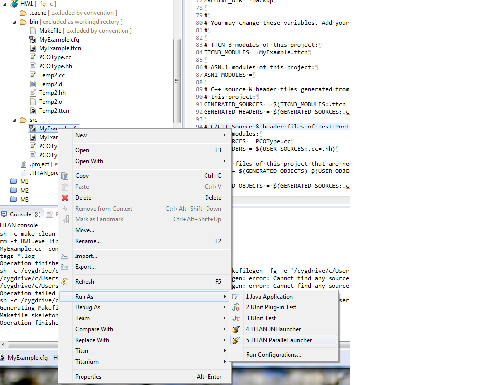

Could you attach the config file from the bin directory? Is it a MyExample.cfg file or a temp cfg file. I suppose it is faulty. The error message comes from the parser, I suppose the cfg file parser. It should send a more user friendly error message so it is a fault and the cfg file is very important for us.
I would suggest a shortcut: Start the HelloWorld this way: Right click on src/MyExample.cfg and select Run As>5 Titan Parallel laucher (see the attched file HWpng.png )
After this follow the description in chapters 4 and 5 of Eclipse_Executor_userguide.pdf.
Best regards
