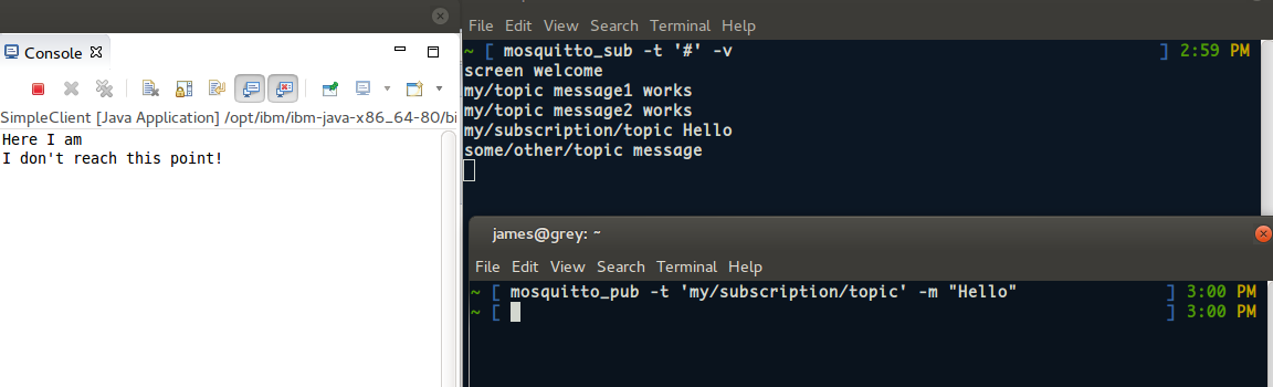

You're subscribing after you've published your messages, so by the time the subscription is complete, the published messages have been and gone.
In the screenshot below, I'm using your code, but I'm manually publishing after the subscription has been made, you can see that the code outputs to System.out and also publishes the message to some/other/topic.
index.php/fa/25826/0/
Make sure you subscribe first! Smile
Hope that helps!
