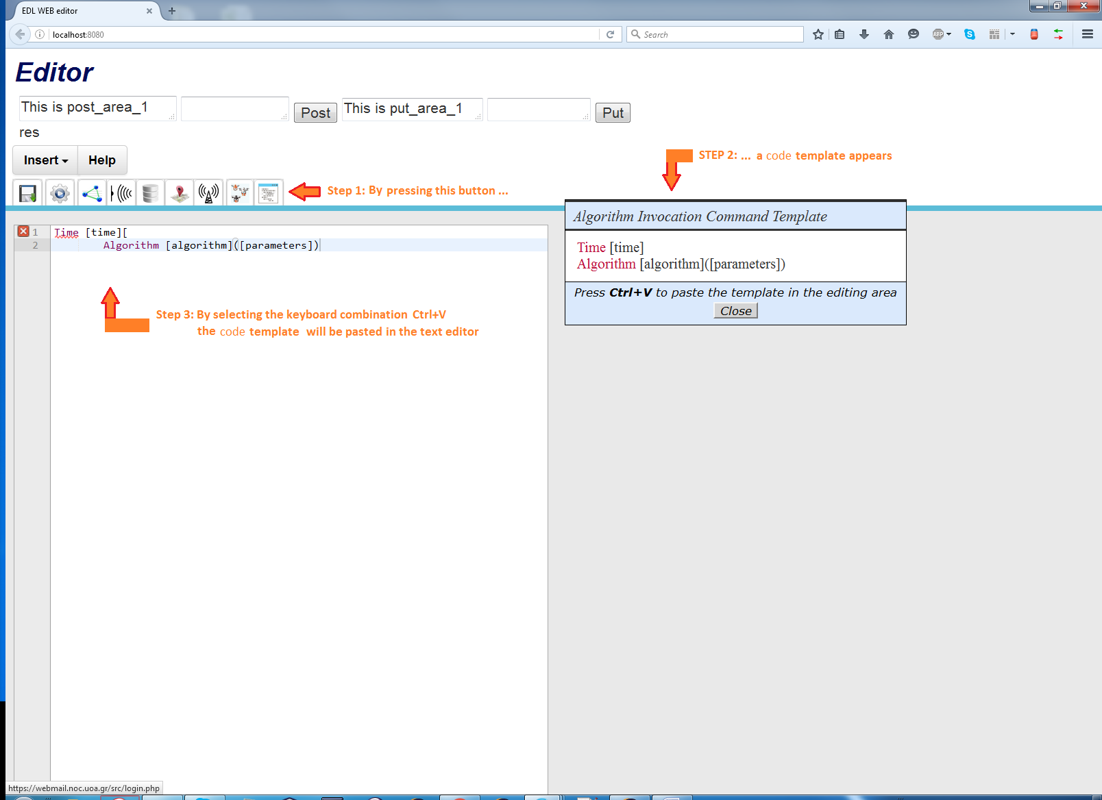

Re: Providing text through JavaScript [message #1730217 is a reply to message #1730124] Fri, 22 April 2016 07:59 Go to previous messageGo to next message
Hi Christian,
i mean that after posting a fullText message (using Httprequest), i am expecting that the Server is responsible to send the fulltext back to the editor. Thought that the server is responsible also for full-filling my edl editor automatically after receiveing the response "200 OK" from the server.
Untill now .
The way that i put text inside the xtext-area has been made with 2 diffrent ways:
i) by typing characters using my keyboard
ii) by inserting programmatically (using jQuery and the clipboard) a code template in the x-text area of my web edl editor.
The second way is made for user convenience, instead of typing a banch off code,
The problem is that i can't paste my code template programmatically inside my editor area, but only by using the key combination cntrl+V.
Any ideas on how to do the "paste" part by using jQuery ?
I am uploading a screenshot, for having a better view of my problem.
Best Regards
[Updated on: Thu, 20 May 2021 11:04] by Moderator
Re: Providing text through JavaScript [message #1730218 is a reply to message #1730217] Fri, 22 April 2016 08:01 Go to previous messageGo to next message
Editor.setValue does not work?
Re: Providing text through JavaScript [message #1730234 is a reply to message #1730218] Fri, 22 April 2016 09:19 Go to previous message
