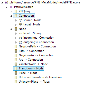

with the following code I get access to the mapped class of my semantic model:
IEditorPart editor = PlatformUI.getWorkbench().getActiveWorkbenchWindow().getActivePage().getActiveEditor();
if (editor instanceof DialectEditor) {
DRepresentation activeRepresentation = ((DialectEditor) editor).getRepresentation();
if (activeRepresentation instanceof DDiagram) {
EList <DDiagramElement> diagram = (((DDiagram) activeRepresentation).getDiagramElements());
String firstElementName = diagram.get(0).getMapping().getName();
How do I get the access to the EAttributes of the Model?
For example: I get the class Transition with the code above and now I want to access the EAttribute label of this Transition.
The Semantic Model is attached below.
Thank you for your help!
  • Attachment: Unbenannt.PNG
    (Size: 11.62KB, Downloaded 431 times)
Is label and attribute of your metamodel or do you want to get the label
of a node of your modeler already computed by Sirius ?

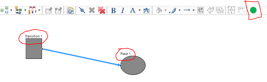

Hey Maxime,
thanks for your answer. I attached an Screenshot of my use case. I need the marked labels.
I also added a button to the menu bar. With that button I want to start a database Query and the Parameters are the labels (from the semantic model) of my diagram elements.
Alex
