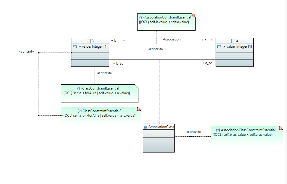

I am trying to specify an invariant in the context of an UML association (this seems to be allowed by both the UML and OCL specification 2.4, as they refer to invariants associated to a Classifier, and an Association is a Classifier).
I have managed to create a valid UML model with the associated OCL constraints (using Papyrus) as shown at the top in the figure below :
index.php/fa/25641/0/
However, There is an error telling me that there is no associated pivot element. To discard any Papyrus bug, I have written a standalone program to load the model, and get the parsed OCLExpressions. And I get the same error as Papyrus.
As a workaround, I tried to define the constraint in the context of an AssociationClass, as shown at the bottom of the figure. This time, I do get a pivot element created, but there is another problem as the pivot.Class created is not added to the corresponding package.
Then I told myself, maybe Associations/AssociationClasses are not supported in Essential OCl, so I defined all my constraints in a Complete OCL document (attached). But the xtext editor doesn't seem to be able to correctly parse the model. I have modified my standalone program to directly parse the complete OCL file and I get the same errors as the xtext editor.
I know I can rephrase my constraints in the context of one of the association ends, as shown in the left of the figure. But sometimes is far more intuitive to write the invariant in the context of the association.

Thanks for the nice simple repro - UML examples are hard to come by and
artidficial ones never go far enough.
I presume you meant [0..1] rather than [0..*] on your association ends,
otherwise e.g.
self.b_ac.value < self.a_ac.value
is really
self.b_ac->collect(value) < self.a_ac->collect(value)
giving an unknown operator Bag::<
The easiest way to test in isolation of Papyrus is to load the UML model
in the UML model editor.
Then use Validate - tends to reproduce UML2 problems.
Then use OCL->Validate - tends to reproduce OCL problems.
For your example just loading test.ocl in the Complete OCL editor shows
many problems.
Association invariants are not supported by Complete OCL. OMG mention
only Class/Operation/Property. Other useful contexts such as State,
Activity fall into the chasm between UML and OCL specifications. Now
Association too can be found there.
(Using Association and AssociationClass as user-defined names for
instances of the same-named concepts risks causing many debugging
confusions.)
Arguably you should use a proper AssociationClass for a class-like
behavior, but the UML2AS conversion eliminates Associations unless they
are actually needed in which case they are concerted to
AssociationClass, so your invariant could be just another trigger to
create an AssociationClass. (just fixed it on branch ewillink/432905).
You are falling foul of limited Pivot OCL support for Association
- https://bugs.eclipse.org/bugs/show_bug.cgi?id=423905
but AssociationClassConstraintComplete, AssociationConstraintComplete
only need navigation from AssociationClass so that ought to work. (just
ClassConstraintComplete2 is more troublesome. Needs navigation to an
AssociationClass; that will have to wait.

Well, I really meant [0..*] . Precisely, navigating from an association class using the association ends always deliver a single object. Quoting from OCL specification 2.4 :
7.5.5 Navigation from Association Classes
We can navigate from the association class itself to the objects that participate in the association. This is done using the dot-notation and the role-names at the association-ends.
context Job
inv: self.employer.numberOfEmployees >= 1
inv: self.employee.age > 21
Navigation from an association class to one of the objects on the association will always deliver exactly one object. This is a result of the definition of AssociationClass. Therefore, the result of this navigation is exactly one object, although it can be used as a Set using oclAsSet() or its "->" shorthand.
So I supposed it will be similar for navigating from an Association. As a matter of fact, I (mis)interpret navigating from an Association as equivalent to navigating from an AssociationClass that happen to have no declared properties (other than the association ends).

HI Ed,
I think I understand what you want to achieve, and it fits well my needs.
My own version of the pivot translation including multiplicities is
So an A::b[mult1] : B to B::a[mult2] : A mediated by AC is converted to:
A::b -> B[mult1] opposite B::a -> A[mult2]
A::AC -> AC[mult1] opposite AC::a -> A[1]
B::AC -> AC[mult2] opposite AC::b -> B[1]
with the additional constraints
Context A
inv : self.AC.b = self.b
Context B
inv : self.AC.a = self.a
But these constraints cannot be enforced by the OCL runtime, maybe it is more a problem for the UML to ecore translation.

Hi Ed
Concerning my example, there was an error in ClassConstraintComplete2 in my original post, so I think that get you confused. My intent was not to navigate to the association class, but to the other end of the association. The correct invariants (updated in the attached files of the original post), with the iteration variables and types expanded, are:
context B
inv ClassConstraintComplete:
self.a->forAll(a: A | self.value < a.value)
inv ClassConstraintComplete2:
self.a_ac->forAll(a : A | self.value < a.value)
The first invariant, ClassConstraintComplete, navigates from B to A using B::a that is a property owned by the Association. It works as expected and I have no errors in the complete OCL editor.
The second invariant, ClassConstraintComplete2, also navigates from B to A but using B::a_ac that is a property owned by the AssociationClass, and in this case I do have an error in the complete OCL editor : "Unresolved property B::a_ac".
Probably this error is already corrected in your branch, as the modifications that you have made ensure that all properties are Class-owned in the pivot. But better to check up.
Your version of ClassConstraintComplete2, on the other hand, is a good test case for navigation from B to the association class and then to A.
Concerning UML2Ecore, I am very aware that this is a lossy translation, my comment was just a small wandering Wink. Actually, the tool I am working on is an semi-automatic transformation from UML to a formal language (Z notation or B-method) and my current objective is to translate the OLC constraints (invariants, pre/post conditions), so I have very similar "lost in translation" problems.
Anyway, my present need is just to be able to parse the OCL constraints and get an easily manipulable abstract syntax representation. So I much appreciate the time you spend correcting and implementing the missing features.
Any idea when your modifications will make it to a nightly build, so I can test it?
G. Vega

Re: UML-OCL ; specifying constraints in the context of an association / association class [message #1729392 is a reply to message #1729350] Wed, 13 April 2016 12:26 Go to previous messageGo to next message
Hi Ed,
I have just downloaded the branch build and made some tests.
For Complete OCL, every thing is working perfectly. I have no errors in the xtext editor, the outiline shows the AS, and I get the parsed expression in my standalone program.
For Essential OCL, there is still a little bug. The constraints owned by the Association do not have a corresponding pivot element associated, so I have errors both in Papyrus and in my standalone program. In my test program I do the following to get the pivot corresponding to a given UML constraint :
org.eclipse.ocl.pivot.Constraint oclConstraint =
ocl.getMetamodelManager().getASOf(org.eclipse.ocl.pivot.Constraint.class, constraint);
For constraints owned by Classes and Association Classes it works ok, but for constraint owned by by an Association I get null.
I have spent some time debugging and, although I am not familiar with your code, I have noticed the following trace leading to the problem:
1) In the first pass, UML2ASDeclarationSwitch.caseAssociation notice that there are owned rules declared and creates the association class and copy the association ends. But it never invokes copyNamedElement, so converter.copyNamedElement is not invoked, and so converter.setOriginalMapping is never invoked.
2) In the second pass, UML2ASUseSwitch.caseAssociation
	public Object caseAssociation(org.eclipse.uml2.uml.Association umlAssociation) {
		assert umlAssociation != null;
		AssociationClass asAssociationClass = converter.getCreated(AssociationClass.class, umlAssociation);
		if (asAssociationClass == null) {
			org.eclipse.uml2.uml.Element owner = umlAssociation.getOwner();
			if (owner != null) {
				org.eclipse.ocl.pivot.Package asPackage = converter.getCreated(org.eclipse.ocl.pivot.Package.class, owner);
				if (asPackage != null) {
					asAssociationClass = PivotFactory.eINSTANCE.createAssociationClass();
					asAssociationClass.setName(umlAssociation.getName());
					org.eclipse.ocl.pivot.Class oclElementType = standardLibrary.getOclElementType();
					asAssociationClass.getSuperClasses().add(oclElementType);
					asPackage.getOwnedClasses().add(asAssociationClass);
		else {
			List<org.eclipse.uml2.uml.Constraint> invariants = umlAssociation.getOwnedRules();
			doSwitchAll(Constraint.class, ClassUtil.nullFree(asAssociationClass.getOwnedInvariants()), invariants);
			copyConstraints(asAssociationClass, umlAssociation, invariants);
		if (asAssociationClass != null) {
			createAssociationClassProperties(asAssociationClass, umlAssociation);
		return asAssociationClass;
the call to converter.getCreated returns null (which is normal because converter.setOriginalMapping was not called). It enters the "then" part of the if and creates the association class in the owner pivot package. Then it creates the association class properties.
Notice that copyConstraints is never invoked, it is only invoked in the "else" part of the if, that is not executed in this scenario.
I don't fully understand the subtleties of the code to propose a realiable fix, but I hope my debugging session helps you track the problem
G. Vega

The Pivot OCL policy is that ALL declarations exist in the metamodel.
(Attempting to prune ambiguities leads to loss of diagnosis and
inconsistency in derivations of the pruning.) With all declarations
available, a lookup returns the ambiguities at which point an extensible
bank of disambiguators prunes the lookup wrt to the lookup requirement,
rather than using globally pruned declarations.
> I do agree that this may suffice for parsing purposes, and will extend
> all association navigation expressions to n-ary associations. But I
> fear this will give the impression that we can deal with n-ary
> associations while in reality there is a gigantic void in the UML-OCL
> integration specification.
It's certainly a risk, but the 'mindless' equivalences seem to support
parsing. I'm hoping that practical limitations are therefore just WFRs
diagnosing stupid combinations of multiplicity. Today there is zero
AssociationClass support - useless. The 'mindless' equivalent is at
least a potentially useful candidate that can be analyzed for flaws.
Implementation representations and evaluation over them is a different
issue.
Ed Willink
Re: UML-OCL ; specifying constraints in the context of an association / association class [message #1729474 is a reply to message #1729463] Thu, 14 April 2016 08:42 Go to previous messageGo to next message
Hi Ed,
Regarding the n-ary associations. I purposely neglected the original multiplicities because I thing they do not have the same meaning in UML as in the pivot model.
Consider the ternary example with some concrete UML multiplicities:
AC with owned ends a:A[0..1], b:B[0..1], c:C[0..1]
What should be the multiplicity of C::AC, A::c, B::c ?
Imagine I have the following links (instances of) AC :
AC1 = {a1,b1,c1}
AC2 = {a1,b2,c2}
AC3 = {a2,b1,c3}
AC4 = {a3,b3,c1}
From an UML point of view, this satisfies all the constrains of the multiplicities. As a UML user, I expect the following evaluations in the example
c1.AC = {AC1,AC4}
a1.c = {c1,c2}
b1.c = {c1,c3}
so the multiplicities should be C::AC[*], A::c[*], B::c[*], How can I infer this from the original multiplicities?
UML multiplicities for n-ary associations are at best unintuitive , and at worst flawed (see for example paper [1] for an interesting discussion). So I am afraid there is no easy translation to pivot, other that not constraining anything (that's why I set the multiplicities to *), and losing the original information. Similar concerns apply to ordered or unique.
Anyway, I agree with you, better to have something working, that allows parsing, than no support at all.
Did you see my other message 1729392 concerning the bug for essential OCL ?
G. Vega

Re: UML-OCL ; specifying constraints in the context of an association / association class [message #1729485 is a reply to message #1729474] Thu, 14 April 2016 10:45 Go to previous messageGo to next message
I only partially recall a conversation with Martin Gogolla last year.
The USE tool developed by his team is probably the only OCL tool that
supports N-ary associations. I think we agreed that N-ary associations
are asymmetric, requiring you to focus on the "1" multiplicity, but I
think I was getting confused about the opposites.
However for your example rephrasing to avoid typos and other confusion:
The UML ternary AorB::c:C[0..1], BorC::a:[0..1], CorA::b:B[0..1] may
be mediated by explicit/implicit AC::a:A[0..1], AC::b:B[0..1], AC::c:C[0..1]
I could interpret this pair-wise as meaning that for a given A,
AorB::c:C[0..1] => there are 0/1 Cs
CorA::b:B[0..1] => there are 0/1 Bs
so 0/1 ACs with optional B and C. However an AC with only one end is not
well-formed so wrt to a given non-null a1 the possibilities are
{a1,null,c1} or {a1,b1,c1} or {a1,b1,null}
This is easily 'parsed' but no doubt more troubling to implement accurately.
{{a1,b1,c1} , {a1,b2,c2}}
is not well-formed since for a given A there are multiple Bs and Cs.
For
The UML ternary AorB::c:C[0..4], BorC::a:[0..1], CorA::b:B[0..2]
mediated by AC::a:A[0..1], AC::b:B[0..1], AC::c:C[0..1]
for a given A , there are 0/1/2 Bs and 0/1/2/3/4 Cs giving more than the
eight (2*4) that I suggested earlier.
The opposites are therefore: A::AC:AC[0..X], B::AC:AC[0..Y],
C::AC:AC[0..Z] where X,Y,Z involve some non-trivial combinatoral
calculations that I would need to refresh my math on before giving the
equations. * will do for many purposes, but practical applications may
benefit from being able to allocate a fixed size buffer.
My interpretation works for 2-ary, yours fails.
For the UML binary A::b:B[0..1] <=> B::a:A[0..1] mediated by the AC with
owned ends AC::a:A[0..1], AC::b:B[0..1]B::a:A[0..1]
you consider that the AC Tuple set
{{a1,b1} , {a1,b2}}
is well-formed, I consider it ill-formed since when we look in the a1.b
EList, we find two entries violating the multiplicity.
Ed Willink
On 14/04/2016 13:42, German Vega wrote:
> Hi Ed,
> AC1 = {a1,b1,c1}
> AC2 = {a1,b2,c2}
> AC3 = {a2,b1,c3}
> AC4 = {a3,b3,c1}
> the example
> c1.AC = {AC1,AC4}
> a1.c = {c1,c2}
> b1.c = {c1,c3}
> Did you see
> https://www.eclipse.org/forums/index.php?t=msg&th=1076487&goto=1729392&#msg_1729392
> Regards
> G. Vega
> [1] The meaning of multiplicity of n-ary associations in UML
> Gonzalo Genova, Juan Llorens, Paloma Martınez
> Software and Systems Modeling
> December 2002, Volume 1, Issue 2, pp 86-97
> http://dx.doi.org/10.1007/s10270-002-0009-3
Re: UML-OCL ; specifying constraints in the context of an association / association class [message #1729505 is a reply to message #1729474] Thu, 14 April 2016 15:59 Go to previous messageGo to next message
> Did you see
This and other fixes regarding Accociation(Class) parsing should be
available now in:
http://www.eclipse.org/modeling/download.php?file=/modeling/mdt/ocl/downloads/drops/6.1.0/N201604141527/mdt-ocl-Update-N201604141527.zip
Ed Willink
Re: UML-OCL ; specifying constraints in the context of an association / association class [message #1729586 is a reply to message #1729505] Fri, 15 April 2016 12:27 Go to previous messageGo to next message
Hi Ed,
I just downloaded the nightly build, and everything is working perfectly. Both for essential and complete OCL. Both with Papyrus and my standalone program.
I have just one last question. In my tool, I have some constraints defined in the UML model, and other constraints in several different complete OCL documents (to allow handling different concerns independently) that I load in the resource set. I would like to have access to the merged complete class with all its constraints, irrespective of the source. I have tried the following in my program :
		 * Traverse complete model (not sure how this API works, just trying it out !)
		CompleteModel completeModel = ocl.getCompleteEnvironment().getOwnedCompleteModel();
		for (org.eclipse.ocl.pivot.Element element : completeModel.allOwnedElements()) {
			if (element instanceof org.eclipse.ocl.pivot.CompleteClass) {
				org.eclipse.ocl.pivot.CompleteClass completeClass = (org.eclipse.ocl.pivot.CompleteClass) element;
				System.out.println("iterating complete class "+completeClass.getName()+" in package "+completeClass.getOwningCompletePackage().getName());
				for (org.eclipse.ocl.pivot.Class partialClass : completeClass.getPartialClasses()) {
					for (org.eclipse.ocl.pivot.Constraint oclConstraint : partialClass.getOwnedConstraints()) {
						System.out.println(" constraint "+oclConstraint.getName());
						show(ocl,oclConstraint);
But it doesn't seems to work. Is this the correct way? is there another API? I didn't find a tutorial or example showing this. Besides, the iteration returns me all the classes, including the UML metamodel and standard profiles, is there any API to only get the pivot classes for my UML model?
Concerning our discussion about n-ary associations. I have to admit that I got completely lost in the last messages. I Think we were not talking about the same thing.
To clarify my mind I wrote a small document with my understanding of UML n-ary associations. I attached it, in case you have some time to take a look. But it is not urgent. As I told you before, the tool I work in transforms from UML to a formal language. It currently doesn't support n-ary associations. So our discussion has been very enlightening for me. I Think I can have minimal support using a similar transformation as the one you proposed to pivot.
In all cases, thank you very much for your time and your reactivity
G. Vega
Re: UML-OCL ; specifying constraints in the context of an association / association class [message #1729589 is a reply to message #1729586] Fri, 15 April 2016 12:34 Go to previous messageGo to next message
CompleteModel::allOwnedElements() looks like an unwated inheritance
waiting to be removed / implemented.
From a CompleteModel descend through the CompletePackages to the
CompleteClasses in each of which you can naigate the PartialPackages /
PartialClasses to the per-Model Packages / Classes. In many cases more
functionality is available by casting to ...Internal.
The API is not written up and is inadequate. If you care to contribute
some helper functions...
The API should be helpful and obvious for users like you.
Ed Willink
