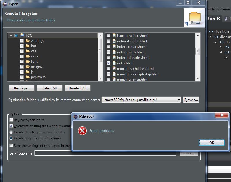

I'm receiving the error RSEF8067 when attempting to export to the root of a remote server. I am able to upload to specific directories but not the root. I don't believe it's a permissions issue because I can edit the file directly. See attachment.

I did have the exact same error araised: RSEF 8067.
I failed this when trying to right-click>Export>... like in this video [protocol/www.youtube.com/watch?v=5ASxltuXKic].
Solution
When connected to your remote system via ftp, and you're able to explore the root :
  • Go to your navigator/explorer
  • Right-click on the file you want to send over,
  • Press Copy
  • in your remote system explorer
  • Right-click on the root
  • Press Paste
that should work.
