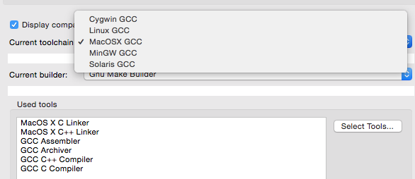

I am trying to use Eclipse MARS2 (on Mac OS X 10.10.5 and 10.11.4) for Java and C++ development. With Java - so far so good.
With C++, CDT only allows me GCC-based toolchains (when "Display compatible toolchains only" is selected).

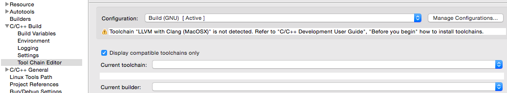

The toolchain in question appears available, as evidenced here:

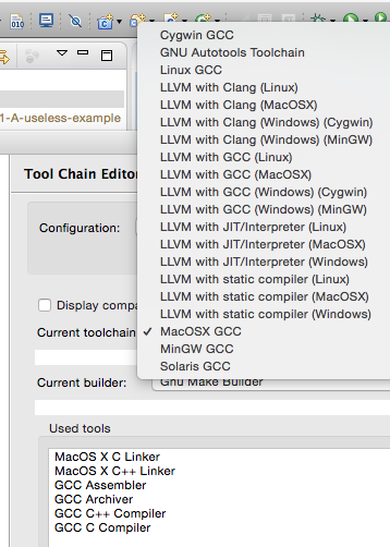

When I force CDT to accept "LLVM with clang (Mac OS X)" toolchain by unchecking the "Display compatible..." checkbox and selecting it, the entire CDT menu becomes screwed up and throws a null-pointer exception.
index.php/fa/25577/0/
There is no way (that I know of) to recover, because I cannot go back to that menu and select something else. Here's the .log contents:

Re: Mars2 on Mac OS X: LLVM with clang (Mac OS X) not available? [message #1728941 is a reply to message #1728837] Fri, 08 April 2016 10:12 Go to previous messageGo to next message
The LLVM toolchain is not very maintained or tested. But if you select MacOS GCC is should work and it will use Clang underneath anyway.

Re: Mars2 on Mac OS X: LLVM with clang (Mac OS X) not available? [message #1728974 is a reply to message #1728941] Fri, 08 April 2016 14:54 Go to previous messageGo to next message
I would be happy to help testing it. But if this (LLVM) toolchain is lacking resources (i.e., authors are too busy to properly maintain it), that of course is a different story.
The fact is, on my Mac there are several compilers: native Xcode (clang and gcc - and I'd rather not use this gcc), and Macports-installed (gcc-5.3 and clang-3.7). The main difference between them is - they shine at different things, but require different flags.
As I see, MacOS GCC toolchain uses gcc/g++ (the one supplied by Xcode). To me it's the worst of these two worlds. I can manually change the compiler, linker, etc. (and it is simple enough), but I don't remember all the flags that LLVM toolchain uses for LLVM (such as --emit-llvm).
Is it practical to get the LLVM toolchain debugged? Or I shouldn't waste my (and others') time, and just reconfigure MacOS GCC toolchain?
