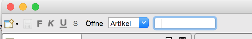

Re: Toolbar not draggable (RCP with compatibility layer) [message #1728503 is a reply to message #1728460] Tue, 05 April 2016 01:26 Go to previous messageGo to next message
Yes, I can drag toolbars in the IDE. For the RCP app: There is no output in the log (besides other non-ui related stuff).
index.php/fa/25531/0/

I have found a solution:
First define a product extension in order to define a css:
      <product
            application="testtoolbars.app" name="Test Toolbars" >
         <property
               name="applicationCSS"
               value="platform:/plugin/testtoolbars/style/testtoolbars.css">
         </property>
         <property
               name="applicationCSSResources"
               value="platform:/plugin/testtoolbars/style/">
         </property>
         <property
               name="applicationXMI"
               value="platform:/plugin/org.eclipse.ui.workbench/LegacyIDE.e4xmi">
         </property>
... more properties
      </product>
Next, add the following in the stylesheet:
.MToolBar.Draggable {
        handle-image:  url(./dragHandle.png);
.MToolControl.Draggable {
and put the png into the folder.
That's it.
