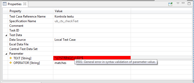

Re: Check that a specific string is not in a text [message #1728228 is a reply to message #1728220] Fri, 01 April 2016 04:44 Go to previous messageGo to next message
Thank you for your advice.
I did it by you and new manul, but Jubula has some problem with syntax. (see attachment please)

Re: Check that a specific string is not in a text [message #1728254 is a reply to message #1728228] Fri, 01 April 2016 06:46 Go to previous messageGo to next message
A couple ofthings to try:
- Put the question mark in single quotes
- Put the whole thing in single quotes

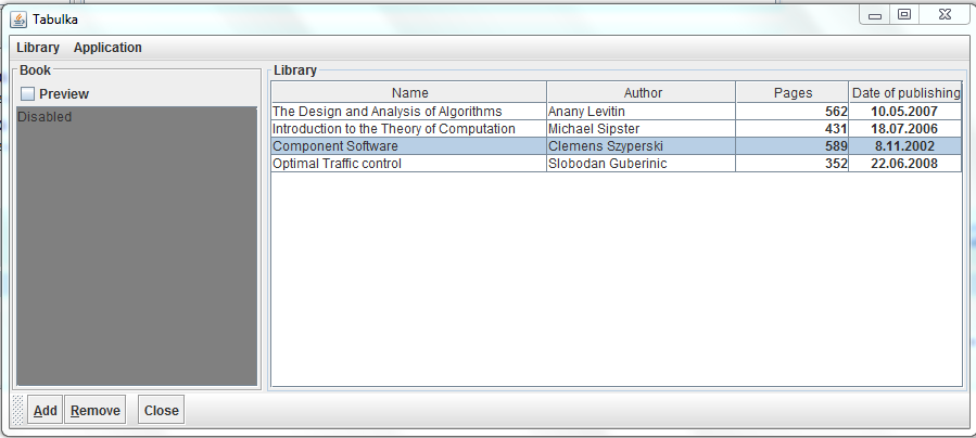

Re: Check that a specific string is not in a text [message #1728278 is a reply to message #1728254] Fri, 01 April 2016 10:58 Go to previous messageGo to next message

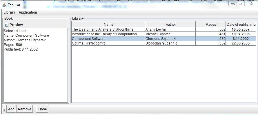

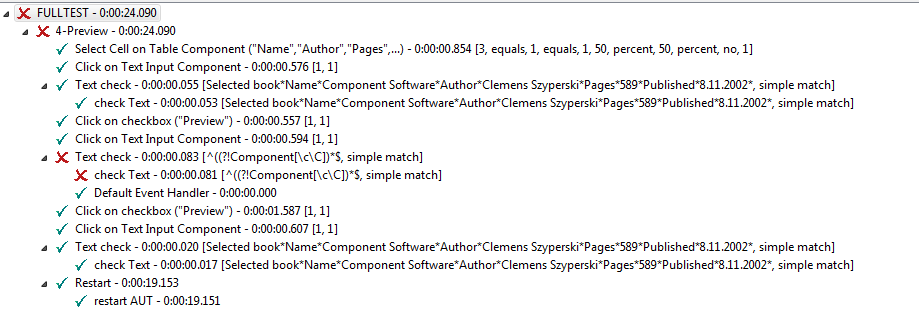

Thanks. When I put whole thing in signle quotes the syntax error is away. But the test is not pass. I don't undestandt it. I attach sreen of application under test and screen of my test.
index.php/fa/25503/0/
index.php/fa/25504/0/
index.php/fa/25505/0/

Re: Check that a specific string is not in a text [message #1728394 is a reply to message #1728278] Mon, 04 April 2016 03:17 Go to previous messageGo to next message
you're using Simple Match as an operator, which doesn't allow full regular expressions. Try using the "matches" operator.

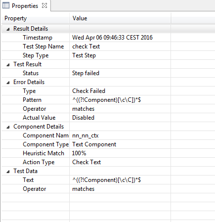

what is the "text input component" you are clicking on before the second, failing check?
and can you add the screenshot of the properties view for the failing step (I want to see what error it is showing, and what text it says is actually in the component).

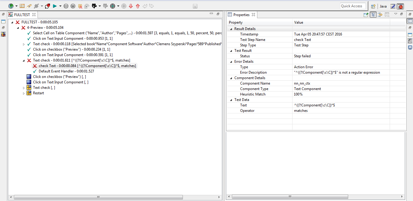

Re: Check that a specific string is not in a text [message #1728603 is a reply to message #1728497] Tue, 05 April 2016 14:52 Go to previous messageGo to next message
Hi, "text input component" is the text box named Preview next the table. I click on it and next step is text checking.
index.php/fa/25545/0/
  • Attachment: err.PNG
    (Size: 57.31KB, Downloaded 922 times)
[Updated on: Tue, 05 April 2016 14:53] by Moderator
Re: Check that a specific string is not in a text [message #1728621 is a reply to message #1728603] Tue, 05 April 2016 21:23 Go to previous messageGo to next message
From your screenshot I can see that you are using double quotes instead of single quotes. What happens if you use single quotes?

Re: Check that a specific string is not in a text [message #1728638 is a reply to message #1728621] Wed, 06 April 2016 03:51 Go to previous messageGo to next message
with single quotes
index.php/fa/25549/0/
    (Size: 16.29KB, Downloaded 901 times)
[Updated on: Wed, 06 April 2016 07:29] by Moderator
Re: Check that a specific string is not in a text [message #1728672 is a reply to message #1728638] Wed, 06 April 2016 07:44 Go to previous messageGo to next message
Did you make sure that the correct component is tested?
Oliver
Re: Check that a specific string is not in a text [message #1728676 is a reply to message #1728672] Wed, 06 April 2016 07:54 Go to previous messageGo to next message
Yes, I'm sure. And value in tested component corresponds to the "Error details/Actual value = Disabled".

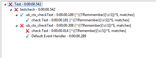

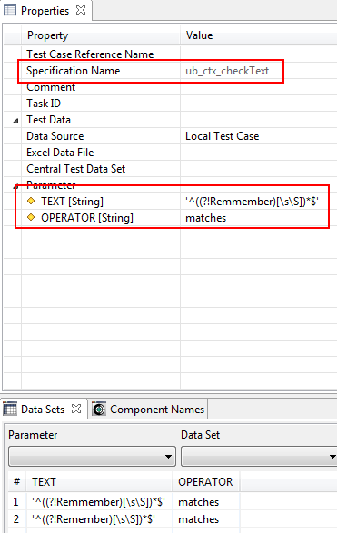

Re: Check that a specific string is not in a text [message #1731723 is a reply to message #1729128] Mon, 09 May 2016 10:35 Go to previous messageGo to next message
shouldn't be very hard to get for that check you want i tried it in a example on my machine. The Solution of Alex should work but you did /c/C instead of /s/S...
see here:
given is:
index.php/fa/25854/0/
my configuration for the testcase:
index.php/fa/25855/0/
to try the testcase i did a set that checks that the given text should not contain 1. Remmember
2. Remember
so the first should pass cause there is no "Remmember" with 2 m's in this label. the second should fail cuase there is a "Remember" in this label...
so lets see:
index.php/fa/25856/0/
tadaaa Smile
Best Regards
Dominik
