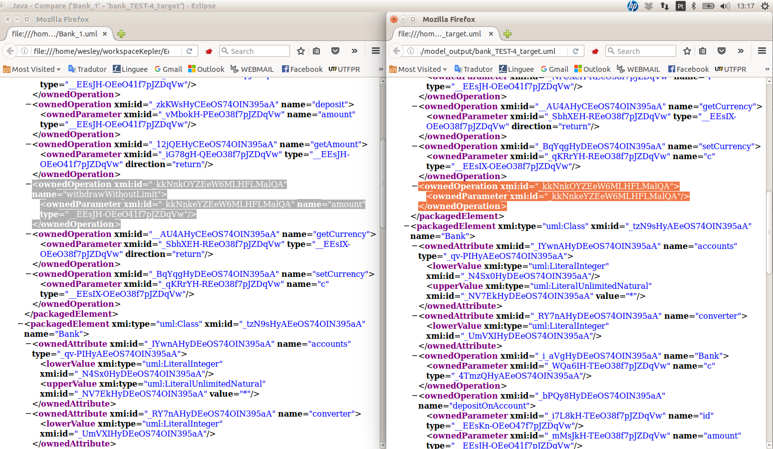

Attached you will find an image with the differences between the two UML files.

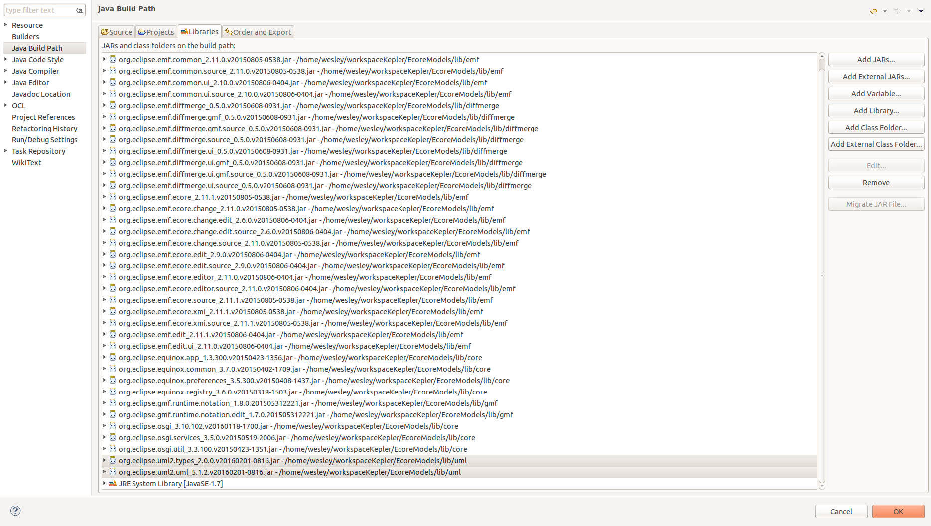

I am using it as external jar file. In the image you can see with jars I am using.
