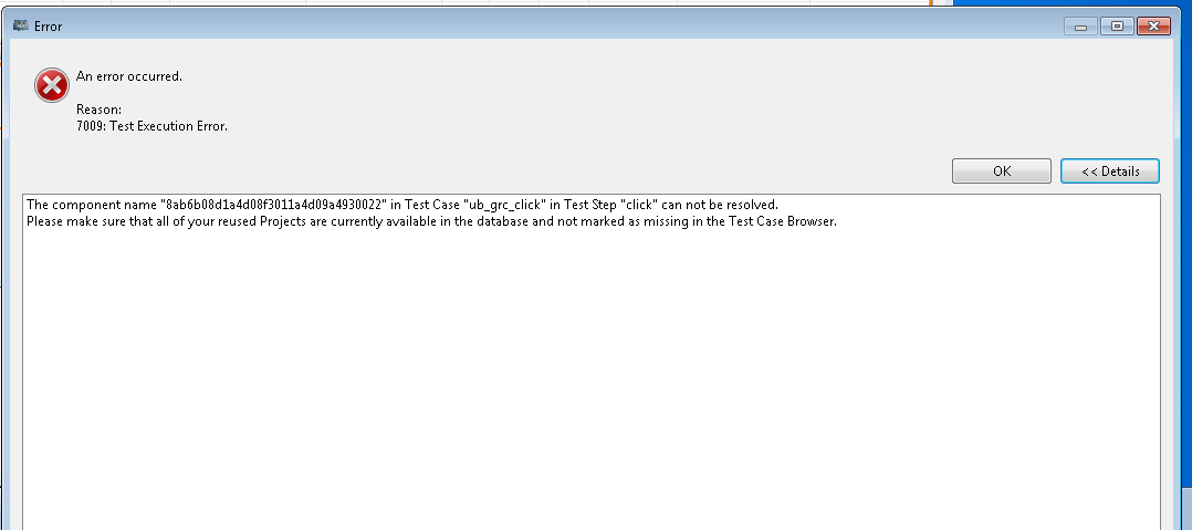

I have an issue. I migrated my test cases to the new version of Jubula 8.2(8.2.2.055) release. I backed up all my test cases plus the reused project in Jubula(jubula_8.2.0.021) the previous release
During the migration phase I got this error :
The import of project "unbound_modules_concrete" failed.
	There is already a project "unbound_modules_concrete" in version 8.2 in the Database.
I deleted the unbound_modules_{swt, rcp,concrete} to import the reused unbound_modules_{swt, rcp,concrete}in my project in version Jubula(jubula_8.2.0.021)
On running my test case i get this error 7009: Test Execution Error ( see attachment).
How do I resolve this issue. I attached also my support information package.

it Looks like the unbound modules are missing in your database. You can manually import them from "<JUBULA_INSTALLATION_FOLDER>\examples\testCaseLibrary". This should solve your problem.
