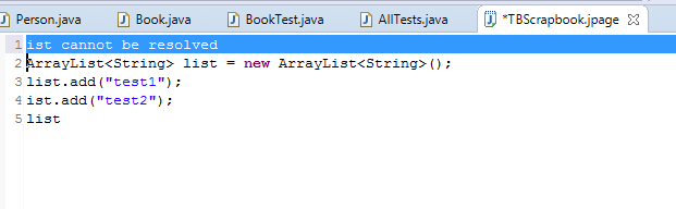

I am working with Mars.2 and Mark Dexter's tutorial (16 lessons). I am trying to follow his instructions on running a script on the scrapbook page. I've imported the needed files for this script. When I inspect the script (Yes, I've highlighted all the lines) It gives me an error: ist cannot be resolved. I had a similar error happen on a previous lesson and after I closed Eclipse and returned to it later then it worked. This time I closed Eclipse and returned about 3 hours later and I'm still getting the same error. I've attached a screen shot of the current occurrence.

If I were you, I'd add a 'l' (lower Case L) at the beginning of line 4.
Re: Scrapbook Page [message #1727755 is a reply to message #1727753] Sat, 26 March 2016 18:09 Go to previous messageGo to next message
I disagree. The Scrapbook Page is an Eclipse feature using Java to power the script. Java does not have a problem resolving the object 'list' so I don't see the problem being with Java. Something in this version of Eclipse does not appear to be working correctly as I believe it has worked in previous versions (at least in 3.3 which Mark is using).
Re: Scrapbook Page [message #1727756 is a reply to message #1727755] Sat, 26 March 2016 18:25 Go to previous message
I do apologize about part of your solution. I didn't see that the 'l' was missing on that line. Once I added that and changed the arguments in the two 'add' statements, the script worked. Thank you for your help.
