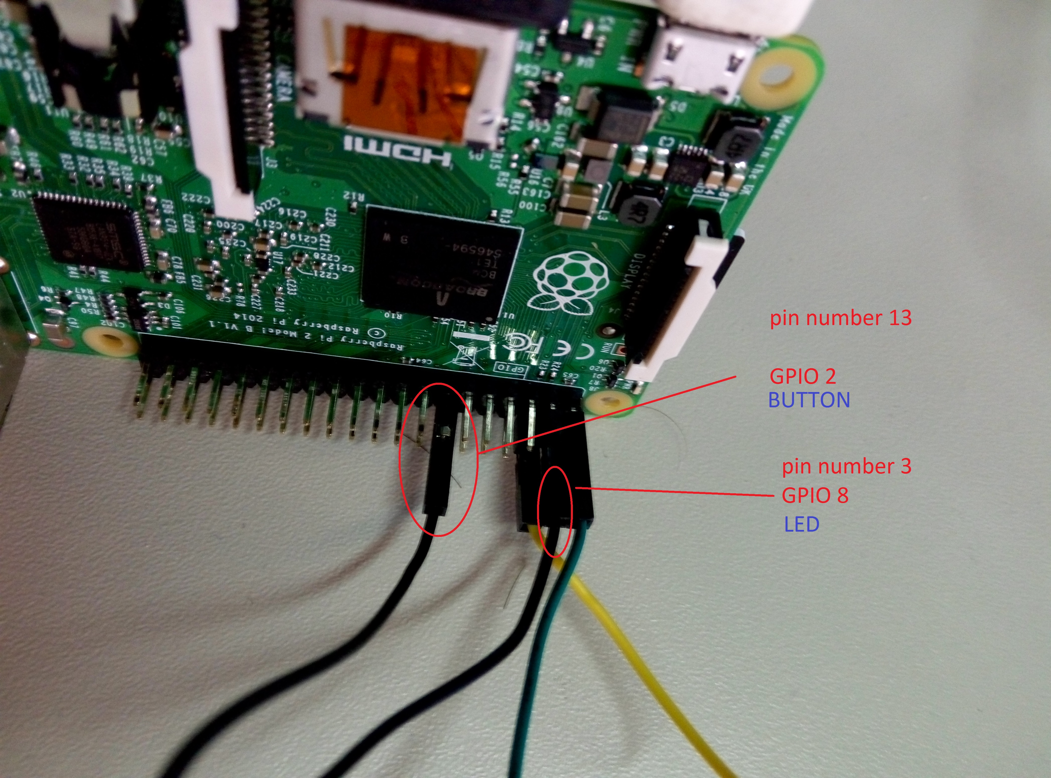

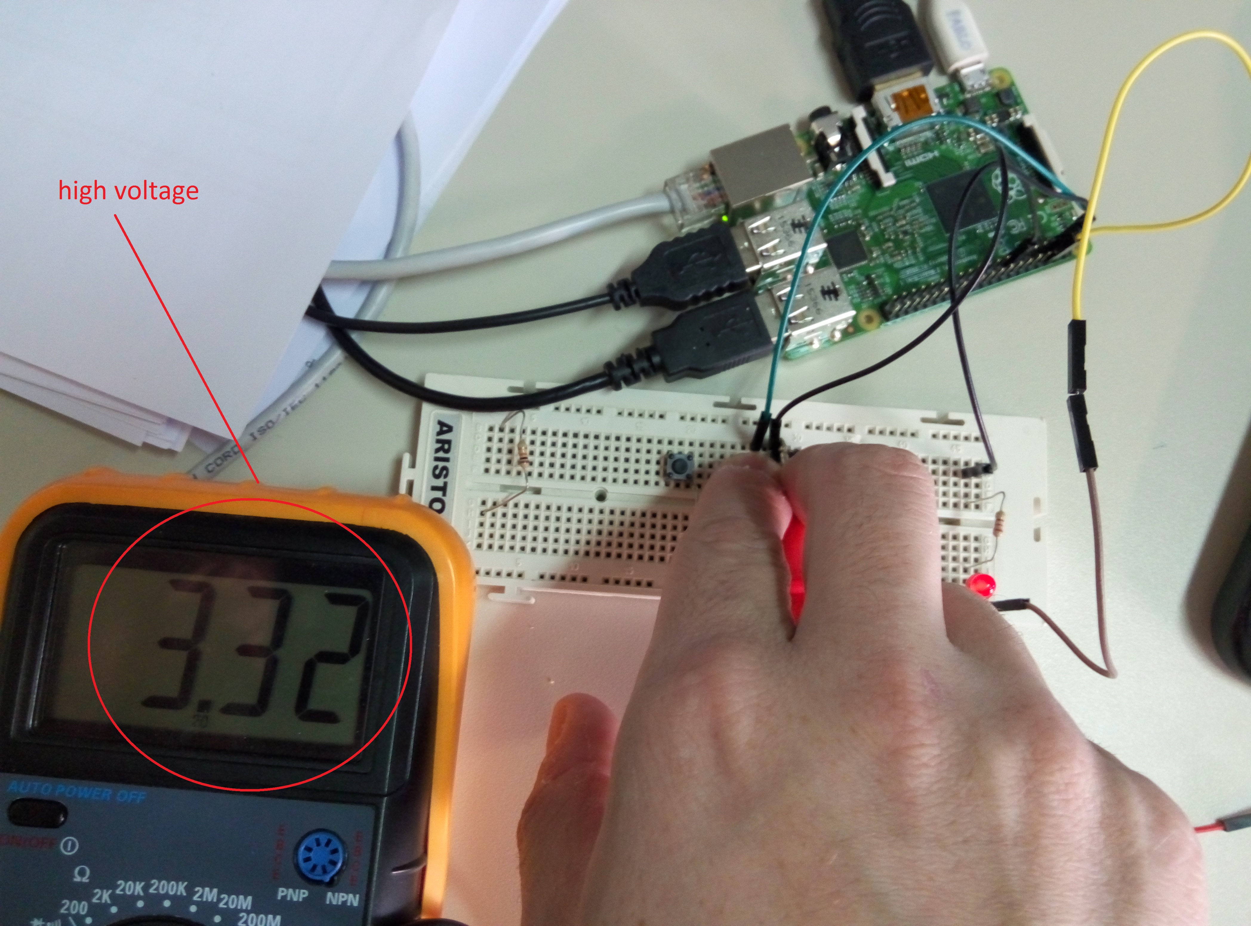

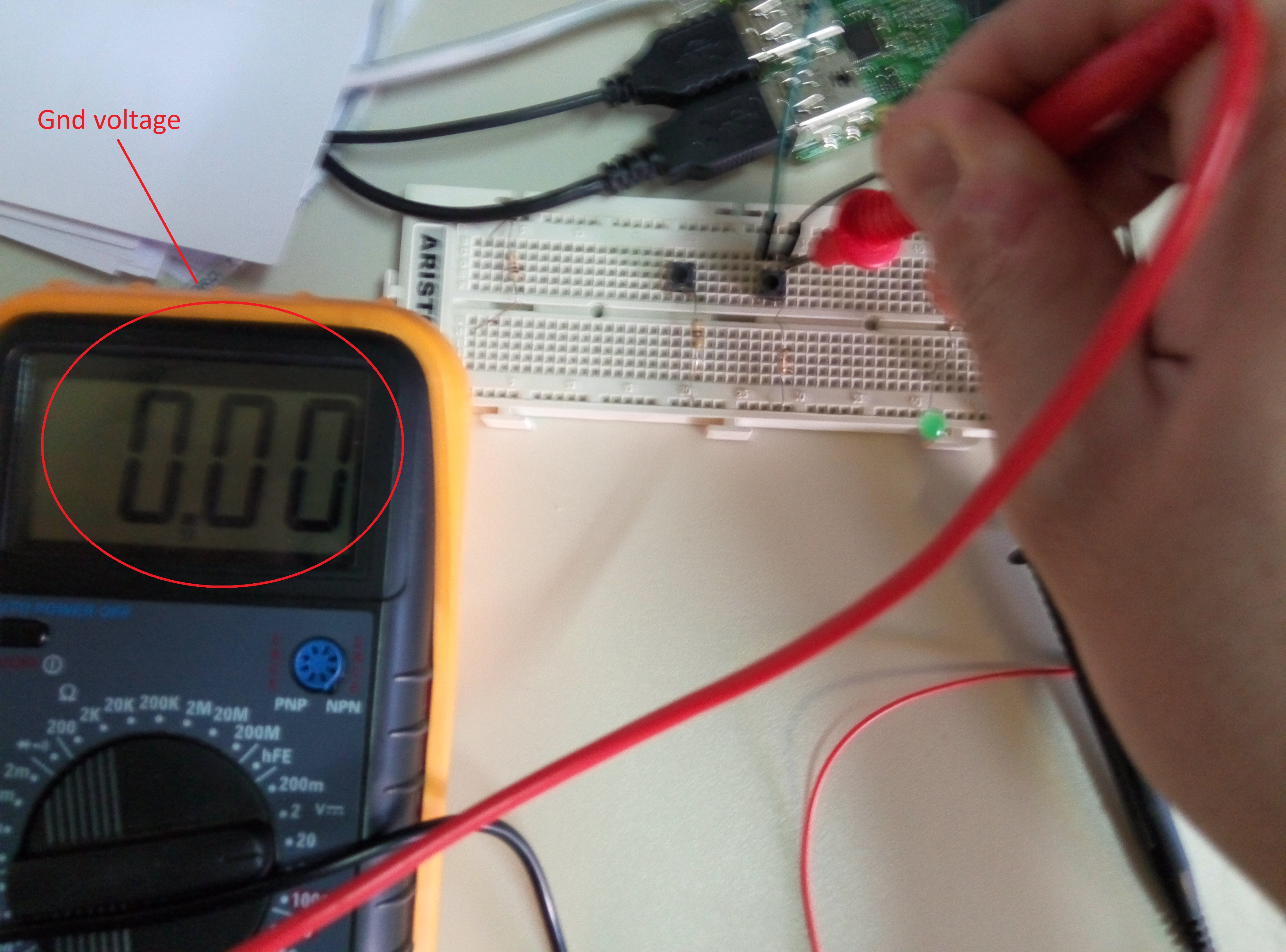

You can check these photos:
the correct voltages are 3.3 V and 0 v.
index.php/fa/25413/0/
index.php/fa/25417/0/

Hi! I don't know until what extend have you tested, but I would do a complete check to the system.
1. Regarding the connections, it seems that everything is fine, but the mapping between pin numbers and GPIO seems not to be right. You marked:
- Pin number 13 -> GPIO 2 -> Button
- Pin number 3 -> GPIO 8 -> LED
The pin numbers seem to be right, but the GPIO don't. According to http://www.raspberrypi-spy.co.uk/2012/06/simple-guide-to-the-rpi-gpio-header-and-pins/
pin number 13 is GPIO 27 and pin number 3 is GPIO 2. You should check that first.
2. Once the GPIO numbers are correctly detected, check through ssh like you did (echoing to export, direction and value) to test the LED and Button (the button part you forgot to write in your post, but it would be the same, but reading the value file instead of writing to it). The value echoed to the export file should be the GPIO and not the header pin number, just to be clear.
3. If the button doesn't work, try using a 5 V output instead of 3.3 V. If the LED doesn't work, maybe you could try another pin that is not shared (in this case, pin number 3 is used also by I2C).

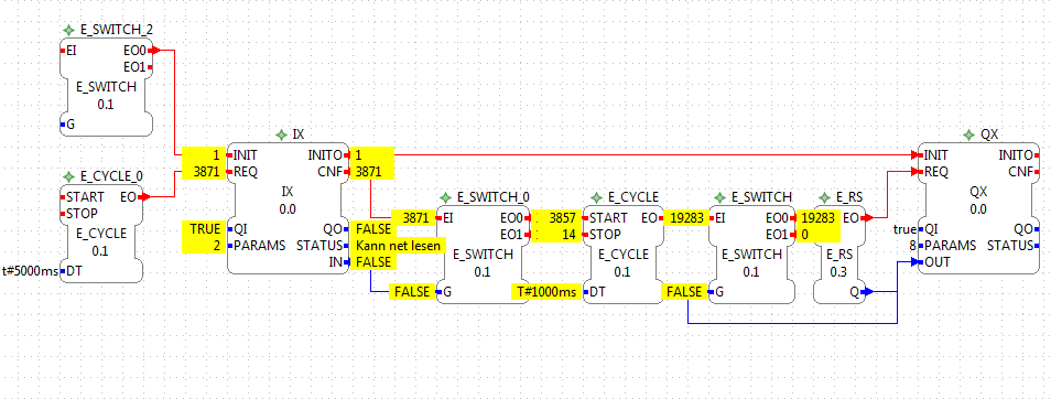

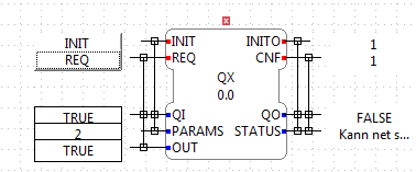

In addition to the comments pointed out by Jose I want to add that according to your screenshots the IX block has an issue which it reports with QO = FALSE. The status string, which is unfortunately german (we need to fix this), says it couldn't read. The question for me now is do you get an error message already on INIT or after the first REQ event?

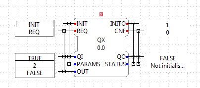

Re: Problem with QX in Raspberry pi [message #1728071 is a reply to message #1727996] Wed, 30 March 2016 14:15 Go to previous messageGo to next message
hi
thank you very much for the suggestions.
first of all , I totally disabled the firewall on my computer , as suggested by Jose Cabra.
answering Alois Zoitl , I'm using the signs of the post https://www.eclipse.org/forums/index.php?t=msg&th=1075043&goto=1726062&#msg_1726062 about on initializing block.
this post says:
"try first to set the QI = TRUE, PARAM = 3 and then click the INIT event.
If the STATUS = OK then you can set the OUT parameter and click the REQ event."
I follow the instructions and when I press the button init , it changes the status to False Not initializate(you can see it in the picture)
index.php/fa/25480/0/
however, if I initialize it without changing anything ( Qi and Out in false , parameter wich gpio port) the status is ok, and then modify Qi to true and Out to true it is still in ok until pulse req , the status change to false and kant net scheiben.
index.php/fa/25481/0/

Re: Problem with QX in Raspberry pi [message #1728143 is a reply to message #1728071] Thu, 31 March 2016 07:07 Go to previous messageGo to next message
I tried the same scenario in a Raspberry Pi, and got partially the same problem as you did. When I tried to initialize the GPIO 2, I got the same problem the first click (STATUS= FALSE), but it worked the second click (STATUS = OK). I mean, after clicking INIT another time after failing, the status was OK. If I deinitialize, the status is OK, and then the first-click problem comes again.
What the initialization function does is the following (PARAMETER = 2):
1. Opens the "export" file and writes 2 to it
2. Opens the file gpio2/direction
3. Writes "out" to it.
If any of the two first opening or the last write fails, the intiallization fails. So I started debugging it, and the problem didn't appear at all when steping on each line of code of the initialization function. Then, I put a breakpoint to each fail case and ran it without stepping, and the problem appeared again when opening the direction file.
In this case, the problem seems to be because when exporting the GPIO, you don't have permission to write to the files for a short time, and after that you have.
See: http://raspberrypi.stackexchange.com/questions/23162/gpio-value-file-appears-with-wrong-permissions-momentarily
How to solve it:
1. Change the forte code to wait for short time before openning the direction file (not the best fast solution)
2. Run forte with sudo.
I tried the 1. solution, not changing the forte code, but using a bash file to export and open inmediately, and then with sleep in the middle of them and the problem was solved in the bash script (this solution worked only once actually)
The 2. solution (user$ sudo forte) doesn't show the problem at all, and at the first click of the INIT event, the STATUS = OK.
So, try running forte with sudo to see if the problem dissapear, and try INIT twice to see if the second time it works.

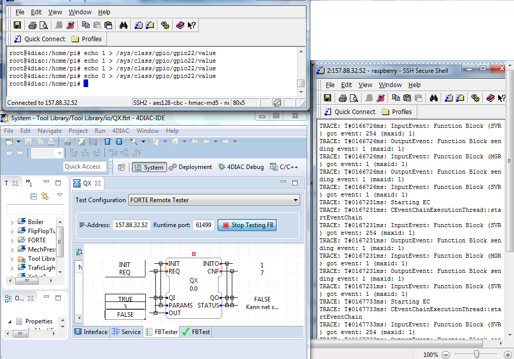

Re: Problem with QX in Raspberry pi [message #1728243 is a reply to message #1727670] Fri, 01 April 2016 06:01 Go to previous messageGo to next message
I try to "sudo" and does not work, add a youtube video to see if it helps.
https://www.youtube.com/watch?v=0PkV7gz4HbE&feature=youtu.be
Re: Problem with QX in Raspberry pi [message #1728251 is a reply to message #1728243] Fri, 01 April 2016 06:11 Go to previous messageGo to next message
Good idea the video! But you are sending the INIT event with QI = FALSE, and that won't initialize it, but actually will de-initialize it, and therefore the REQ won't be able to read anything because QX is not initialize.
You should follow the sequence as the message post you linked before:
"try first to set the QI = TRUE, PARAM = 2 and then click the INIT event.
TIP: Keep QI always TRUE, both for INIT and REQ.
