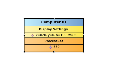

Here is some screens of what I have :
When I move this Element :
index.php/fa/25385/0/
I need the listener to notify me something like "Computer01" was moved.
But here is what I get on the console instead :
The x of the object "org.eclipse.gmf.runtime.notation.impl.BoundsImpl@1d53c272 (x: 225, y: 230) (width: 208, height: -1)" has changed
The y of the object "org.eclipse.gmf.runtime.notation.impl.BoundsImpl@1d53c272 (x: 225, y: 230) (width: 208, height: -1)" has changed
Do you have an idea ?
Alex.
