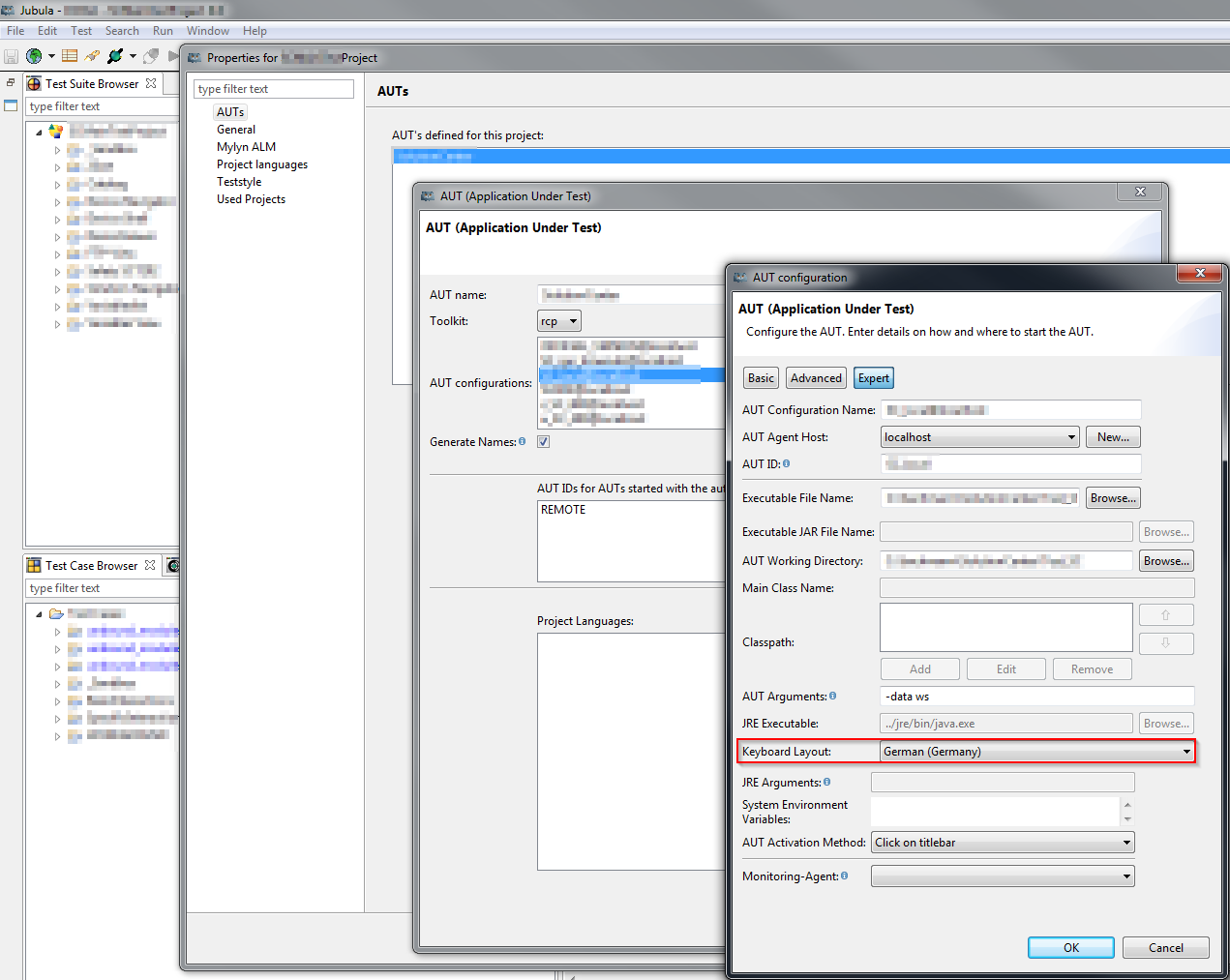

Did you set the Keyboard layout to italian?
Re: Problem of keyboard [message #1727517 is a reply to message #1727515] Wed, 23 March 2016 08:34 Go to previous messageGo to next message
you can find the setting for keyboard layout in your AUT setting
index.php/fa/25388/0/

My problem is not really a language problem but rather a problem of difference between the keyboard of a laptop and a desktop computer.
