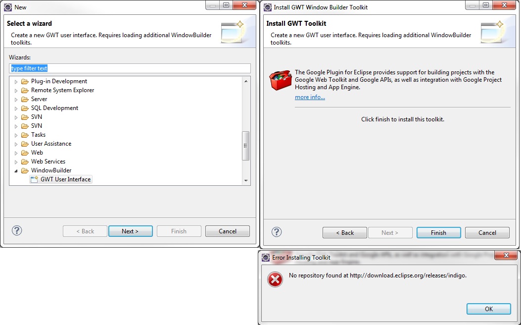

Can you get a screenshot (or 2) showing the error with as much detail as possible. It's hard to imagine what you're experiencing (although I will mention that any feature you install, such as the GWT plugins) can add a repo to the list, so that might be what's happening).
Re: Indigo repo keeps showing up [message #1727403 is a reply to message #1727396] Tue, 22 March 2016 13:47 Go to previous messageGo to next message
index.php/fa/25379/0/
attached a screenshot of the three windows when trying to add a GWT class.
Thing is even if I delete the Indigo repo and reboot it just shows back up without me doing anything.
I want to test out GWT and simply cannot. Even downloaded the zip and installed from there and this window still opens. Also note that I have installed everything related to WindowBuilder.
