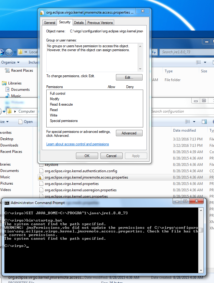

Re: 100% brand new Virgo 3.6.4 will not start. [message #1727459 is a reply to message #1727383] Wed, 23 March 2016 05:11 Go to previous messageGo to next message
Your screenshot shows "Administrator" in "Group or user names".
Did you try to "Remove all groups and users from the list and select 'Apply'."?
I have no Windows 7 at hand, but I think it should be empty like in the documentation screenshot: https://www.eclipse.org/virgo/documentation/virgo-documentation-3.6.4.RELEASE/docs/virgo-user-guide/html/images/install-windows-2-SecuritySettings.png
[Updated on: Wed, 23 March 2016 05:12] by Moderator
Re: 100% brand new Virgo 3.6.4 will not start. [message #1727500 is a reply to message #1727459] Wed, 23 March 2016 07:30 Go to previous messageGo to next message
Same issue.

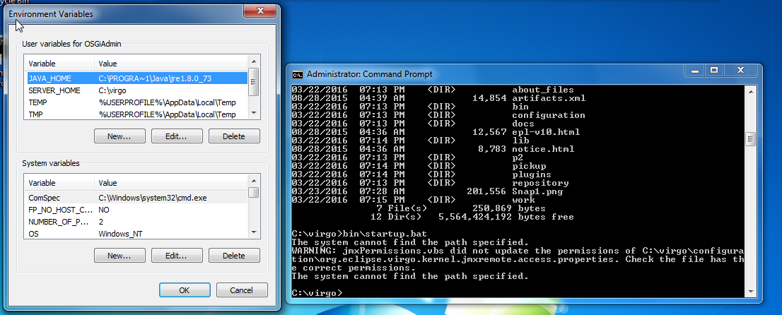

Re: 100% brand new Virgo 3.6.4 will not start. [message #1727512 is a reply to message #1727500] Wed, 23 March 2016 08:24 Go to previous messageGo to next message
I just tested same set-up on my Windows 7 as Paul mentioned it here. Although, I get the same Warning message at the very beginning of the start-up Virgo starts up successfully. I think the root cause is something else which causes Virgo not to start.
Paul, can you please set the JAVA_HOME as described in the User Guide https://www.eclipse.org/virgo/documentation/virgo-documentation-3.6.4.RELEASE/docs/virgo-user-guide/html/ch04s04.html? After doing that I would recommend to log-out of the system and log-in again, just to be sure. And then try to start Virgo again using the start-up script from Virgo itself
Re: 100% brand new Virgo 3.6.4 will not start. [message #1727535 is a reply to message #1727512] Wed, 23 March 2016 11:03 Go to previous message

index.php/fa/25389/0/
