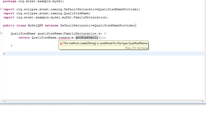

i try this but QualifiedName.create not work ?

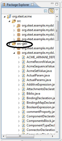

it should be thier ?
  • Attachment: gen.png
    (Size: 15.94KB, Downloaded 179 times)
[Updated on: Mon, 21 March 2016 13:36] by Moderator
Re: Could not find any exported element of type 'FamilyDeclaration' -> Slot 'familyDeclaration' i [message #1727286 is a reply to message #1727284] Mon, 21 March 2016 13:41 Go to previous messageGo to next message
no - inside src.
src-gen is for generated stuff only. not for generatedonce/manual code

the version of xtext is
Version: 1.0.2.v201102150722
not 2.0
Re: Could not find any exported element of type 'FamilyDeclaration' -> Slot 'familyDeclaration' i [message #1727313 is a reply to message #1727306] Tue, 22 March 2016 02:24 Go to previous messageGo to next message
Yes in this Stone Age version the api was different and the return type was string not qualified name

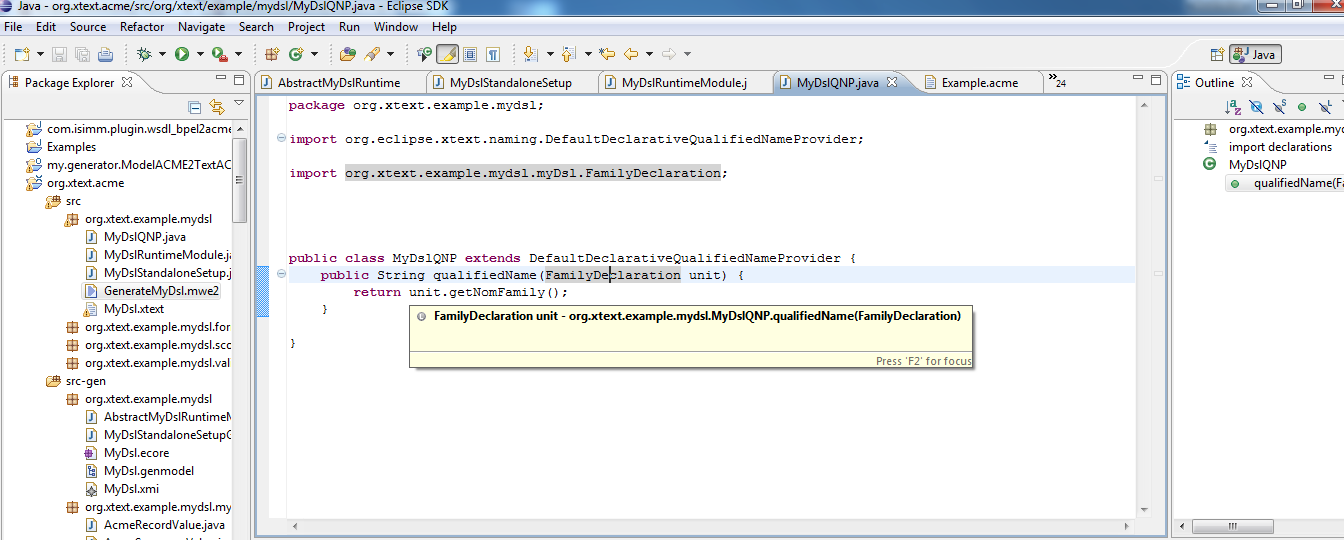

as i said. if i remember correctly it is/was
public class MyDslQNP extends DefaultDeclarativeQualifiedNameProvider {
public String qualifiedName(FamilyDeclaration unit) {
return unit.getNomFamily();
Re: Could not find any exported element of type 'FamilyDeclaration' -> Slot 'familyDeclaration' i [message #1727490 is a reply to message #1727479] Wed, 23 March 2016 07:04 Go to previous messageGo to next message
when i generate the DSl i don't have result the class MyDslQNP .that what i have
[Updated on: Wed, 23 March 2016 07:09] by Moderator
Re: Could not find any exported element of type 'FamilyDeclaration' -> Slot 'familyDeclaration' i [message #1727491 is a reply to message #1727490] Wed, 23 March 2016 07:06 Go to previous messageGo to next message
i do not understand this question. the qualifiednameprovider i a class you create manually
Re: Could not find any exported element of type 'FamilyDeclaration' -> Slot 'familyDeclaration' i [message #1727494 is a reply to message #1727491] Wed, 23 March 2016 07:14 Go to previous messageGo to next message
yes that what i do i add a image in the last msg
Re: Could not find any exported element of type 'FamilyDeclaration' -> Slot 'familyDeclaration' i [message #1727495 is a reply to message #1727494] Wed, 23 March 2016 07:14 Go to previous messageGo to next message
Can you share all needed to reproduce this.
Re: Could not find any exported element of type 'FamilyDeclaration' -> Slot 'familyDeclaration' i [message #1727498 is a reply to message #1727495] Wed, 23 March 2016 07:24 Go to previous messageGo to next message
it work thanks a lottttttttttttttttttttttttttt
