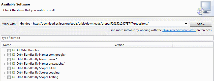

I see a number of Orbit bundles after adding that site?

Re: package org.apache.commons.io 1.3.1 [message #1727257 is a reply to message #1727256] Mon, 21 March 2016 11:46 Go to previous messageGo to next message
Initially, no, just via the Add button - but I get that same list if adding the software repository then selecting it.
