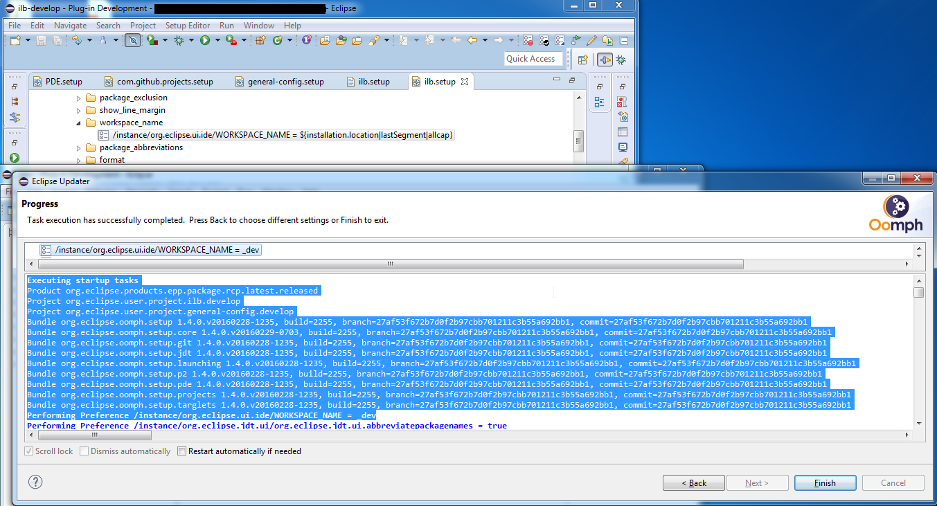

Hey Eike,
I use two project files during the installation (one only contains custom user preferences). Just to make sure the installation location is not somehow cached (I deleted the content and reinstalled a couple times into ilb-develo2), I tried "ilb-develop99" ... but the result is the same.
index.php/fa/25354/0/
Kon

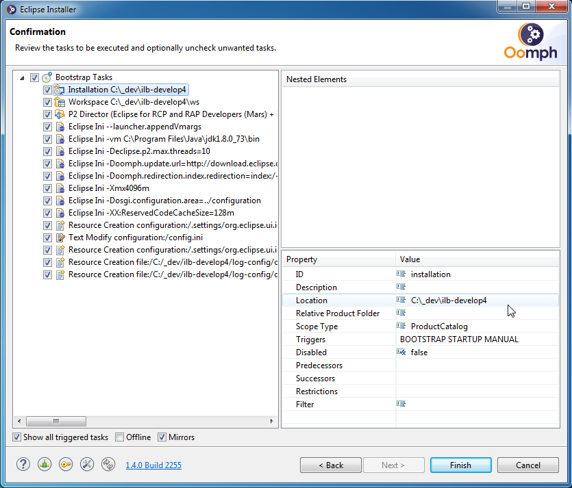

If you "Perform Setup Tasks..." in your IDE, click the "Show all triggered tasks" checkbox and select the very first
task in the list (should be the InstallationTask), what does it show in the Properties table? Please make another
screenshot.

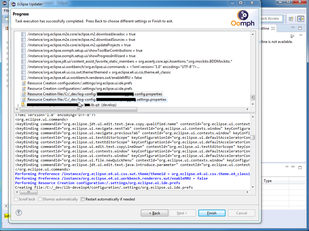

Re: ${installation.location} points to base path [message #1727301 is a reply to message #1727167] Mon, 21 March 2016 17:31 Go to previous messageGo to next message
Hey Eike,
just to make it simpler, I just installed from one project file.
The first screenshot shows the correct path (also for resource creation tasks on the bottom).
index.php/fa/25374/0/

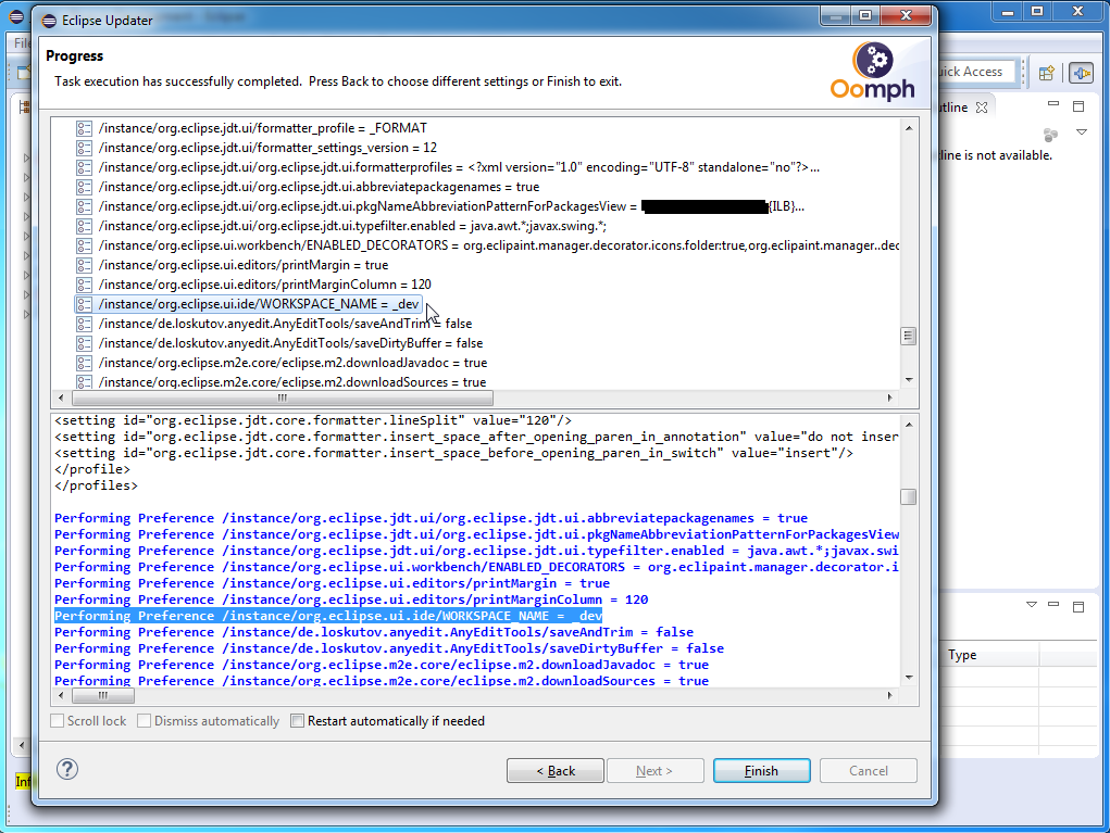

From here, it's getting strange since WORKSPACE_NAME is set to ${installation.location|lastSegment}
index.php/fa/25375/0/
As the path has been changed, the files that were already created during bootstrap are created again (because they do not exist, right?).
index.php/fa/25376/0/
