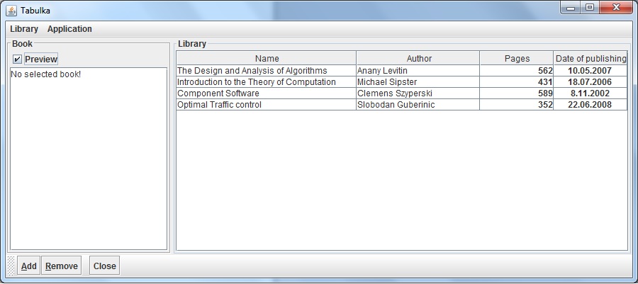

i'm new in Jubula, I started few days ago. I'm testing very simple app in Java/Swing. It's a table with 2 options - remove or add rows (via Menu or Buttons).
I need test removing third row from this table with button.

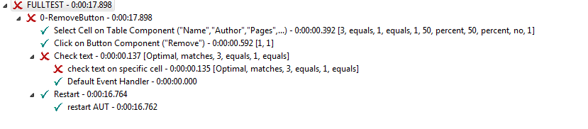

So I did :
1. Select->Table->Select Cell
2. Click on Button
3. Check->Table->Check cell with cell spec
But there is some problem with checking. I want remove 3. row and the next step is checkin this row - if is there a value which is shifted from 4. row.
Can you tell me, where the id the problem? What am I doing wrong?

MY APP:
index.php/fa/25341/0/
MY TEST RESULT:
index.php/fa/25342/0/
