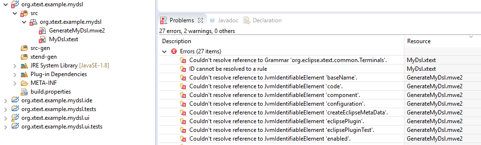

Just generating a generic XText project creates 27 errors.
Here are the 2 in MyDsl.xtext
Description Resource Path Location Type
Couldn't resolve reference to Grammar 'org.eclipse.xtext.common.Terminals'. MyDsl.xtext /org.xtext.example.mydsl/src/org/xtext/example/mydsl line: 1 /org.xtext.example.mydsl/src/org/xtext/example/mydsl/MyDsl.xtext Grammar Problem
ID cannot be resolved to a rule MyDsl.xtext /org.xtext.example.mydsl/src/org/xtext/example/mydsl line: 9 /org.xtext.example.mydsl/src/org/xtext/example/mydsl/MyDsl.xtext Grammar Problem

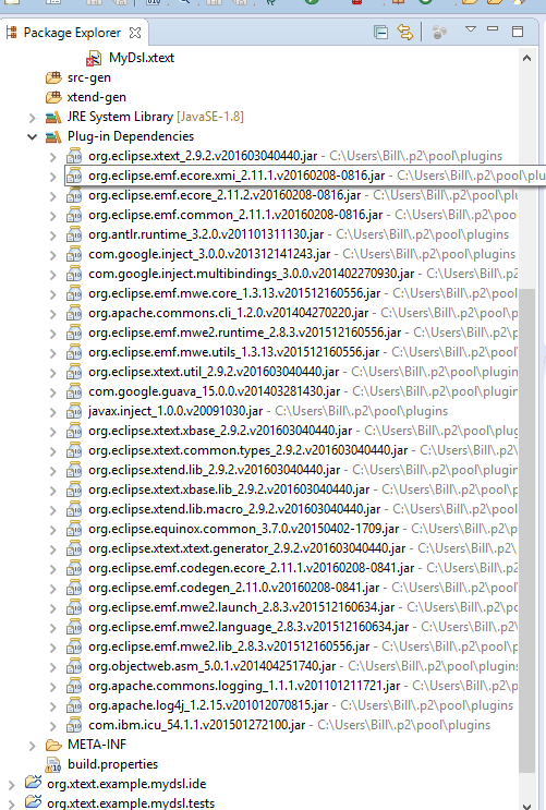

Can you share a screenshot of the tree in the project explorer?
Re: apparent wizard failure [message #1726719 is a reply to message #1726713] Tue, 15 March 2016 17:34 Go to previous messageGo to next message

Can you open the point plugin dependencies in the tree
Re: apparent wizard failure [message #1726725 is a reply to message #1726721] Tue, 15 March 2016 17:45 Go to previous messageGo to next message
index.php/fa/25322/0/index.php/fa/25321/0/

This looks perfectly fine. Are you sure you have build automatically on and called project clean build once
