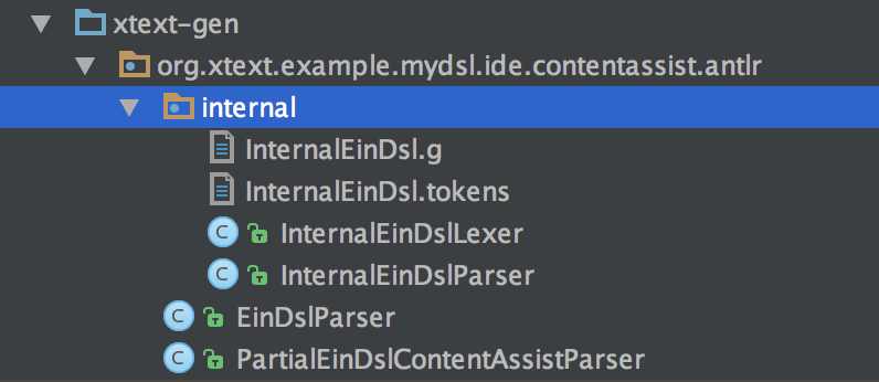

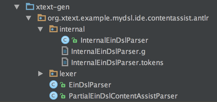

Re: Regarding ignoreCase [message #1725854 is a reply to message #1725851] Tue, 08 March 2016 01:49 Go to previous messageGo to next message
No ,I dont see it generated after.
before
index.php/fa/25215/0/
after
index.php/fa/25216/0/
