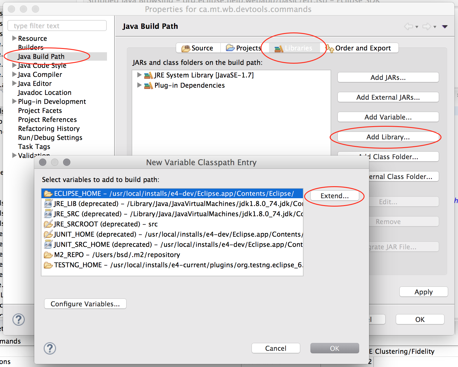

Or you can reference the plugins from your classpath. I've attached a snapshot indicating how you'd set the library referencing the ECLIPSE_HOME variable.
index.php/fa/25174/0/
Since you said this was a standalone application, I assume you just export a Runnable Jar and include the referenced libraries.
