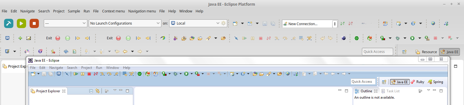

We are attempting to standarize across all the possible platforms used in our company and I've noticed that Eclipse for JavaEE appears to be different on Linux than Eclipse for JavaEE on Windows.
For one thing there are a lot more menu items. In fact, there are 3 (yes, count them) three "File" drop menus. And two help menus. The first help menu simply holds an "About" submenu. The second one holds everything else!
And that is just the beginning.
index.php/fa/25175/0/I will try to post some screen shots once I'm a bit more familiar with how to do that.
Any insight as to why this is so vastly different would be helpful as I'd like our devs to be able to switch between OS's without having to relearn the IDE interface. Kinda defeats the purpose of settling on a "Standard" IDE for use across the project.

Ok, uploaded the image and inserted into the original message. I have the Windows version of the menubar and toolbars in front with the Linux version behind. And yes, I did intall via a tar, not via apt-get. I even went back to double check that I downloaded the right file!
So I'm really confused at this point. They both have the same plugins, etc... They should be identical. (or very nearly so)

On Linux, you have the Launch Bar installed and enabled, not to mention some redundant and oddly named menus.
Can you give the names of the files you downloaded on both platforms?

Yes, the launch bar is part of the differences, but I don't think it explains the redundant and oddly arranged File and Help menus. The names Context Menu and Navigation Menu look suspicious, make me think that maybe some demo or sample plugin has gotten installed.
Jeff, what shows up in the extra File and Help menus, and the Context Menu and Navigation Menu?
