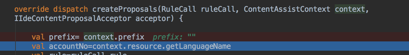

Re: Different prefix for Special Character in RuleCall [message #1725315 is a reply to message #1725295] Wed, 02 March 2016 08:38 Go to previous messageGo to next message
index.php/fa/25160/0/
Could you verify this for this method as well.For the one you shared I get "profit #" .My input is "plot profit #"
  override dispatch createProposals(RuleCall ruleCall, ContentAssistContext context,
    IIdeContentProposalAcceptor acceptor) {
        val prefix= context.prefix
[Updated on: Wed, 02 March 2016 08:44] by Moderator
Re: Different prefix for Special Character in RuleCall [message #1725319 is a reply to message #1725315] Wed, 02 March 2016 08:50 Go to previous messageGo to next message
yes, but
override protected _createProposals(RuleCall ruleCall, ContentAssistContext context, IIdeContentProposalAcceptor acceptor) {
println("%%%%%%" + ruleCall.rule?.name + " " + context.prefix)
super._createProposals(ruleCall, context, acceptor)
%%%%%%Query
%%%%%%QTypekeyWord
%%%%%%MeasureList
%%%%%%Measure
%%%%%%Query
so what is your actual question problem?
Re: Different prefix for Special Character in RuleCall [message #1725332 is a reply to message #1725319] Wed, 02 March 2016 10:30 Go to previous messageGo to next message
My Question is should I expect "profit #" as the value of context.prefix .because when I type the question "plot profit p" I get "profit p" as prefix . So why not "profit #" when my input is "plot profit #"
Re: Different prefix for Special Character in RuleCall [message #1725333 is a reply to message #1725332] Wed, 02 March 2016 10:42 Go to previous messageGo to next message
but i get 'profit #' as prefix ?!?

Re: Different prefix for Special Character in RuleCall [message #1725337 is a reply to message #1725335] Wed, 02 March 2016 10:51 Go to previous messageGo to next message
yes but i still have adopted
org.eclipse.xtext.ide.editor.contentassist.IdeContentProposalProvider.isAcceptable(ContentAssistContext)
which insists of the last thing to be a character.
you have to adaopt this as well
p.s.
once more using a debugger might help
Re: Different prefix for Special Character in RuleCall [message #1725835 is a reply to message #1725337] Mon, 07 March 2016 22:57 Go to previous message
Thanks Christian. This solved my issue
