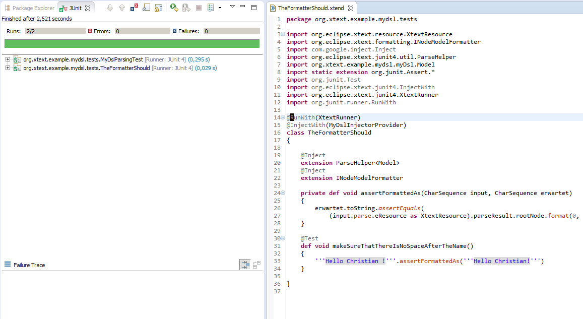

I now have a formatter that formats and unittests that (in eclipse) tell me that the formatting works.

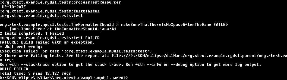

However if I build with gradle, the formatting test fails. It must be something with resolving the formatter? But there is no NPE..
Screenshots and the example are included.

have a look at the test build/reports/tests/index.html
what kind of error does it report
Re: Use Formatter1 in Xtext 2.9 [message #1725253 is a reply to message #1725252] Wed, 02 March 2016 02:35 Go to previous messageGo to next message
if i have a look at the Formatter gradle generates i can see that this formatter throws exactly that error
Re: Use Formatter1 in Xtext 2.9 [message #1725254 is a reply to message #1725253] Wed, 02 March 2016 02:38 Go to previous messageGo to next message
You're right, it's
nameAssignment_1 cannot be resolved
Re: Use Formatter1 in Xtext 2.9 [message #1725255 is a reply to message #1725254] Wed, 02 March 2016 02:45 Go to previous messageGo to next message
yes then this i the bug i created.
you can try to apply my workaround
Re: Use Formatter1 in Xtext 2.9 [message #1725259 is a reply to message #1725255] Wed, 02 March 2016 03:02 Go to previous messageGo to next message
