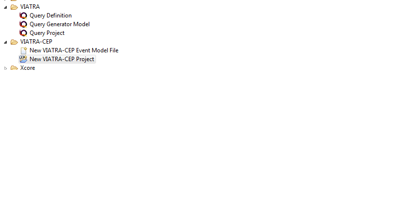

hello.
thank's for answer but there are part's in help like VPM modelspace or Viatra Textual Editor Project , There is no viatra I've installed. I'm just part shown below.
thank's.

Re: install viatra [message #1725291 is a reply to message #1725245] Wed, 02 March 2016 04:42 Go to previous messageGo to next message
looking at your screenshot, it seems to me you have managed to install the brand new version of VIATRA from the CI update site (given that you have a VIATRA Query project that is only available since a week or so). On the other hand, the 'VPM modelspace' or the 'VIATRA Textual Editor' are related to the older VIATRA2 framework that is not being developed since about 2013. I know, this is a bit confusing; we are trying to clean up the references; if required, consult the https://wiki.eclipse.org/VIATRA/History wiki site for a very brief history.
In general, I would not recommend searching for that old version unless you have some specific needs. I would be glad to help you choose what you should install from where (and what kind of documentation is available for them), but first please share with us what you want to use VIATRA (or VIATRA2) for.
Cheers,
Zoltán
