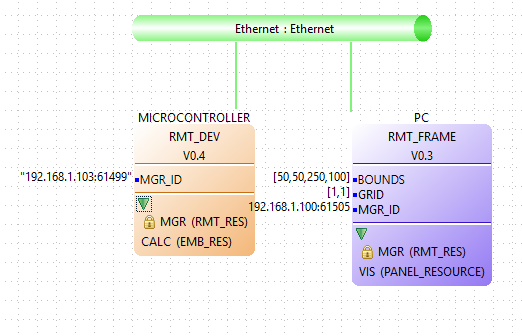

However I am now facing the problem of using 4Diac and Raspberry Pi.
I have install Forte in Raspberry Pi.
However I don't know how to download the application to raspberry Pi. I tried to use Xplus3 sample application and changed the ip address in MGR_ID in the sample as similar as my raspberry pi 's ip addr but I could not download the program. The IDE say x.x.x.x:61499 connection refused.
Could you please give me a clear instruction how to use 4Diac for raspberry pi.
The version is 4Diac 1.8 with compiled Forte.
Thank you so much

Re: Raspberry Pi platform support [message #1725646 is a reply to message #1725629] Sat, 05 March 2016 13:00 Go to previous messageGo to next message
HI,
In principle as you described your setup seems to be correct. Are your PC and your raspi in the same ethernet network? Have you started FORTE on your raspberrypi (e.g., by connecting with ssh and invoking ./forte on the raspi)?

Re: Raspberry Pi platform support [message #1725658 is a reply to message #1725646] Sat, 05 March 2016 17:36 Go to previous messageGo to next message
After running the Forte in raspberry, the download process is fine. However, I got the problem of the application. When I tried to type some number into, it could not show the result. I have searched and found this link. I tried to solve the same but it could not work for me.
Here is the link.
sourceforge.net/p/fordiac/discussion/708249/thread/918eb215/
I have also another problem which maybe related to that.
I run the Xplus3 in Window 10. It works fine.
I run the Xplus3 in Linux Mint 17. It couldn't work. The same problems as the Raspberry. ( enter number but not so the result )
I hope you have faced the problems and could give me some advice.
If it relates to the Firewall, could you please tell me the way of doing it on Linux. ( The Window 10 has the popup of firewall access but Linux doesnt have )
Re: Raspberry Pi platform support [message #1725683 is a reply to message #1725658] Sun, 06 March 2016 14:55 Go to previous message
i would guess that it has something todo with your Linux network setup. As application we normaly don't have much control on the routing of UDP multicast packets. This has to be done with some routing configuration in your os. So the first question I typically ask how many network interfaces you have running? As network interface counts WIFI, cable, or also USB connection to Raspi or Beaglbone if you have Ethernet over USB enabled. In order to ensure that your udp packets are routed between FORTE and FBRT you need to have a loopback dive runing and also rout the multicast packets over them.
I hope this helps.
Alois
