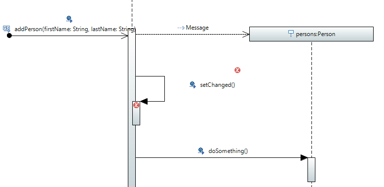

I am trying to analyze serialized XMI of sequence diagrams, because I need to generate code from it, although I think there are some bugs with sequence diagrams serialization. In the attached picture I am trying to create a self-message on lifeline, but the attribute covered is not serialized on the Execution Specification Block. When I validate the diagram, it gives me these 2 errors:
The feature 'uml::InteractionFragment::covered' of 'RootElement::Interaction1::BehaviorExecSpec2Finish' with 0 values must have at least 1 values
The feature 'uml::InteractionFragment::covered' of 'RootElement::Interaction1::setChanged_MessageRecv' with 0 values must have at least 1 values
Sometimes it's serialized without errors, but the most of the times it's not, therefore I am not able to analyze XMI programatically. I tried Papyrus version 0.10 under Kepler and everything seems fine, but in this older version I am not able to create Lifeline that represents the whole class, only property and that is not acceptable for me.
So my question is, is this some sort of a bug or am I doing something wrong? thanks

Hi Thomas,
in particular the sequence diagrams capabilities of Papyrus are not very mature and reliable. It improved a little in Luna and Mars, but it is still far away from being convenient.
The first problem you reported is not an XMI issue, but a SD issue. I am pretty sure that the attributed covered is already missing in the model. This happens sometimes in the older versions of Papyrus, but I do not why and when.
Marc-Florian
