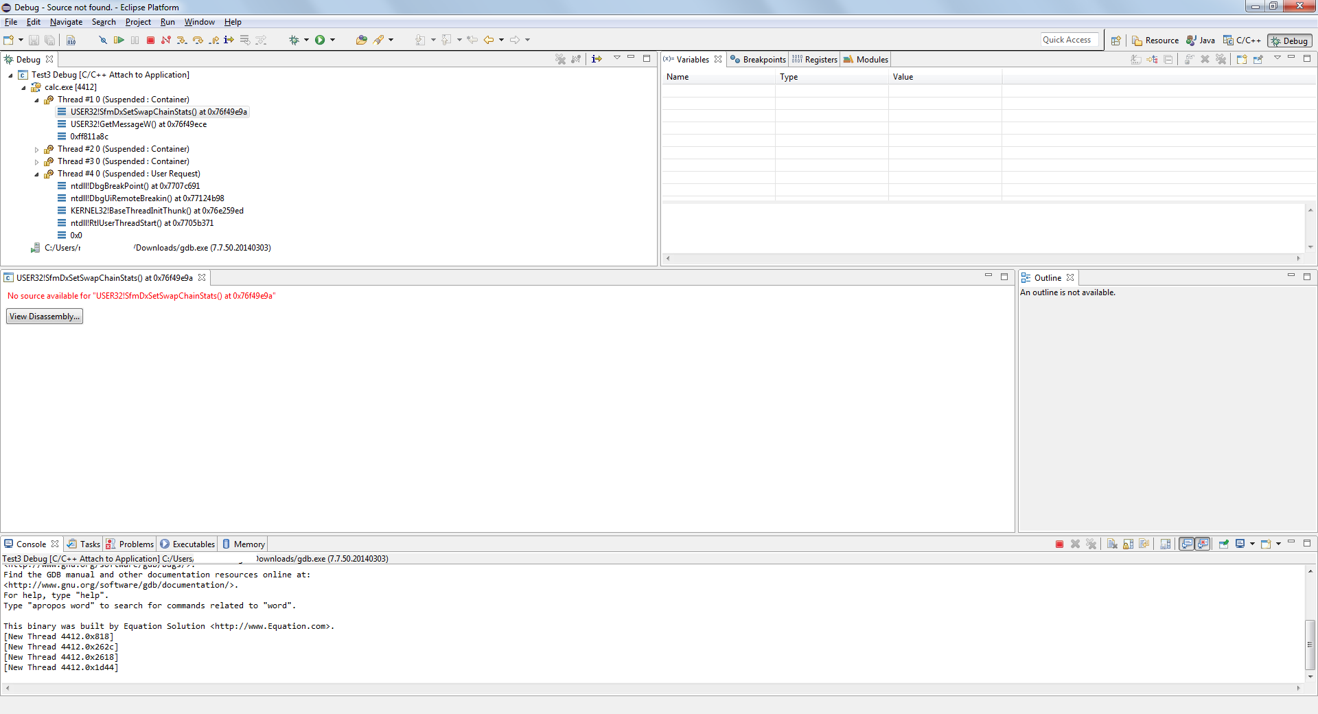

When attaching to a process without having any source code, it shows the "No source available" editor.
This can lead to a situation where only the "View Disassembly" button is visible:
index.php/fa/25085/0/
In that case, it seems it would make more sense to use the Disassembly Editor instead of the Disassembly View. Also, if there is only one option for the user "View Disassembly", why not show directly the disassembly editor without clicking on a button first?
That way, if the user clicks on a method in the debug view, the disassembly editor is shown directly.

OK, the disassembly editor seems to work in the same way as the disassembly view, but this is fine for me.
That way, only one disassembly editor can be active at the same time, showing the disassembly of the currently selected thread.
This is only shown case no file is in the frame data, so the user couldn't attach source anyway.

I am not too sure about what the default should be. There are two use cases, each of which needs a different default, or other dealing with:
1) User is doing (typically) embedded development with their source code in an editor (on the left) and the disassembly view (on the right). In this case if I stepped into some code that did not have source lookup option (i.e. your above screenshot case) I wouldn't want or expect the location of my disassembly stepping to change.
2) User is doing (typically) host development where they would rarely or ever use the disassembly view because it is too low level. In this case having the disassembly editor used in your above case makes perfect sense.
That said, you can mitigate against option 1 by having the disassembly in both the editor and the view for your use case.
