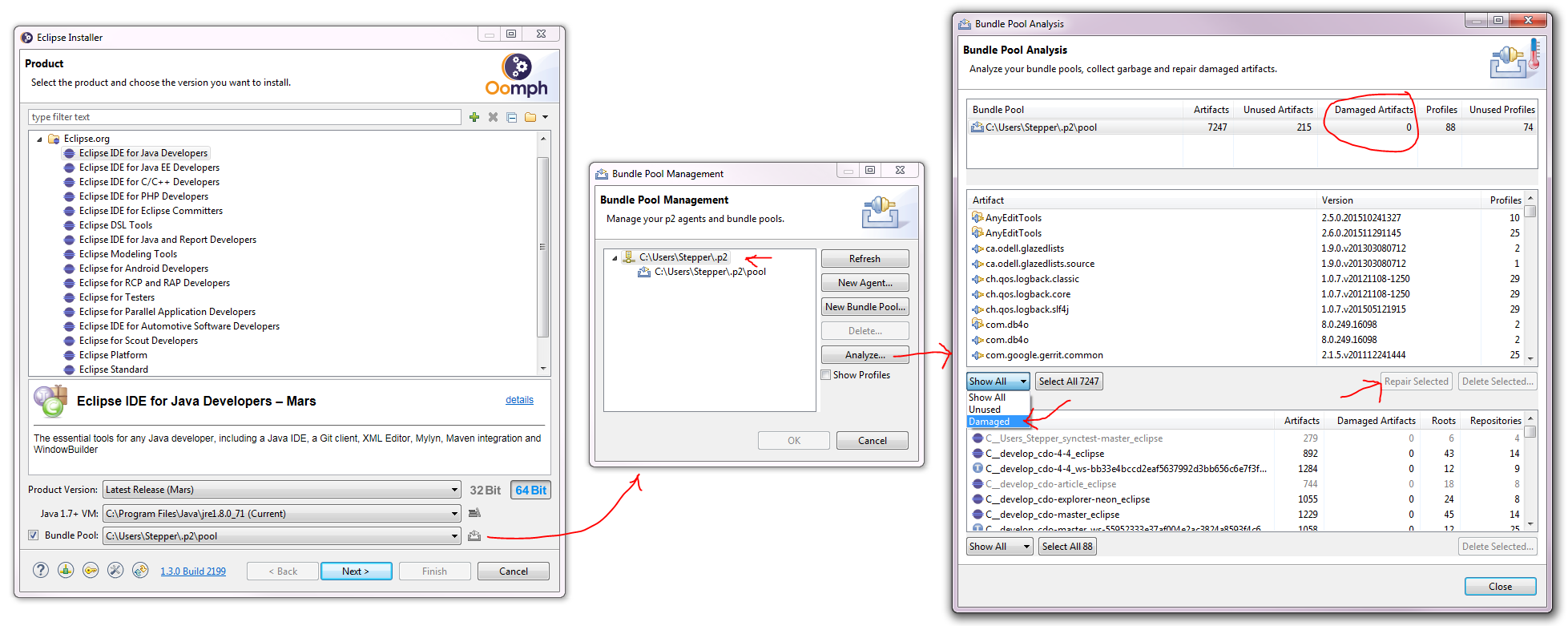

With the Eclipse Installer (in advanced mode on the first page; in simple mode via the "Bundle Pools..." menu item) you
can open the Bundle Pool Analysis tool. There you can wait for the damage detection to finish and then either attempt to
repair or delete damaged artifacts. I've attached a screenshot for you. It's kind of an advanced function, so please
make a backup copy of your entire pool before you try to modify it. And please let me know how the procedure worked for
you. Good luck ;-)

Yes. Please extract it to some location on your disk and run the "eclipse-inst" executable to start the Eclipse
Installer. If you have at least one startable Eclipse IDE on your machine, you can also open the Bundle Bool Analyzer
via Preferences -> Oomph -> Bundle Pools.

Outstanding. It worked. It worked. Wow.
So since I have that Oomph section in the Eclipse instance that was having the problem (and since the $HOME/.p2 isn't specific to a single instance, it would be any on the same host), does that mean I didn't even need the one from the installer, I could have run the analyzer directly from the Oomph preferences?
