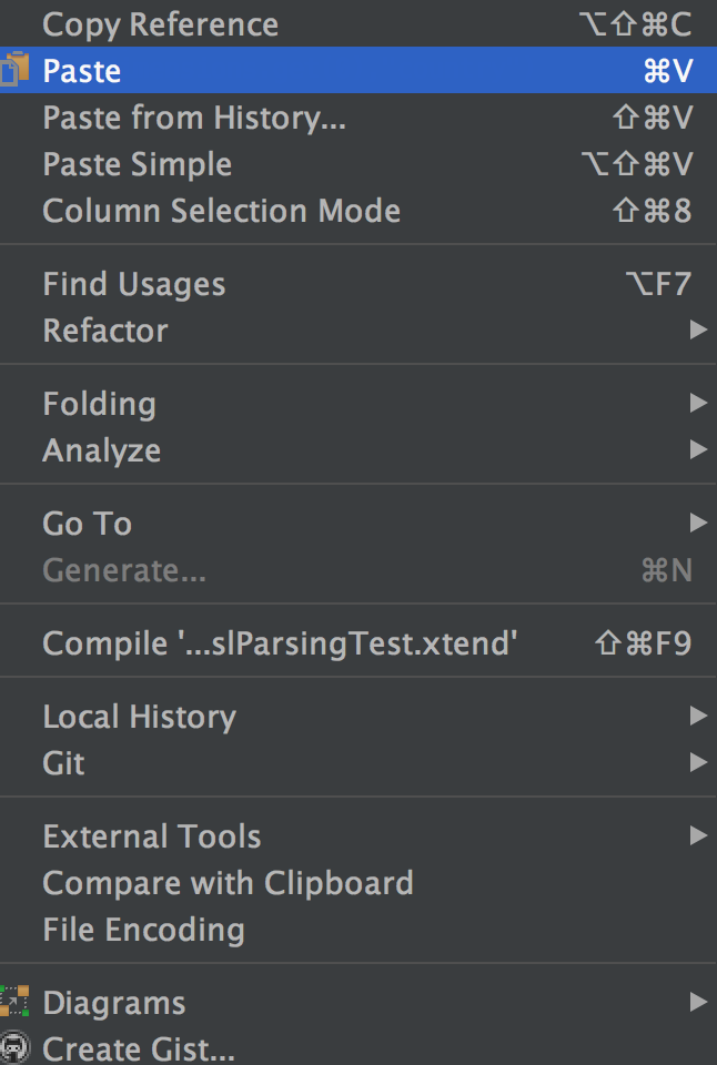

HI,
I am trying to run individual test cases from the Auto-created "parsing test.xtend".In intellij I do not see a "run as" for the particular class. Moreover, When I try to debug the test the breakpoint does not stop at the test.
However, When I put the breakpoint in the generated java test class it stops . And it is also identified as a test class and I can run individual tests.
What could be the issue with the "xtend" test class. I wish to debug directy in the test i write in xtend and not in java. Please suggest.

Thanks for the reply. Breakpoint does not stop in xtend . If I set in java it stops. !

Well ,this works .but in my xtext project I dont even get the option to run as --debug,etc..

as i sead you have to call debug on the generated Java file
Re: Running ParsingTest in intellij [message #1723819 is a reply to message #1723816] Thu, 18 February 2016 04:19 Go to previous messageGo to next message
So i can't debug an xtend test?. only debug the java.? Also ,this java test class is not geting generated on the fly. I have to clean install to generate .Is it usual for the setting in xtext project? :/

hi,
i cannot answer this.
what i can tell you.
- there is no run or debug command on xtend files. please open a ticket for this.
- if you debug the generated Java file and set a breakpoint in the xtend file, the the flow will stop in the xtend file
- to get this running the xtend builder must run "somehow" automatically. on my Setup this happens
(there is a xtend facet in the Projects iml)
i create the Project using the wizard and do a grade clean and a grade build first and a refresh all grade Projects besore startng editing
since i am not what deep into intellij that is all what i personally can do
can you please file a bug if he "somehow" automatically does not work in your Setup
with detailed seteps what you are exactly doing when creating the xtext Project.
