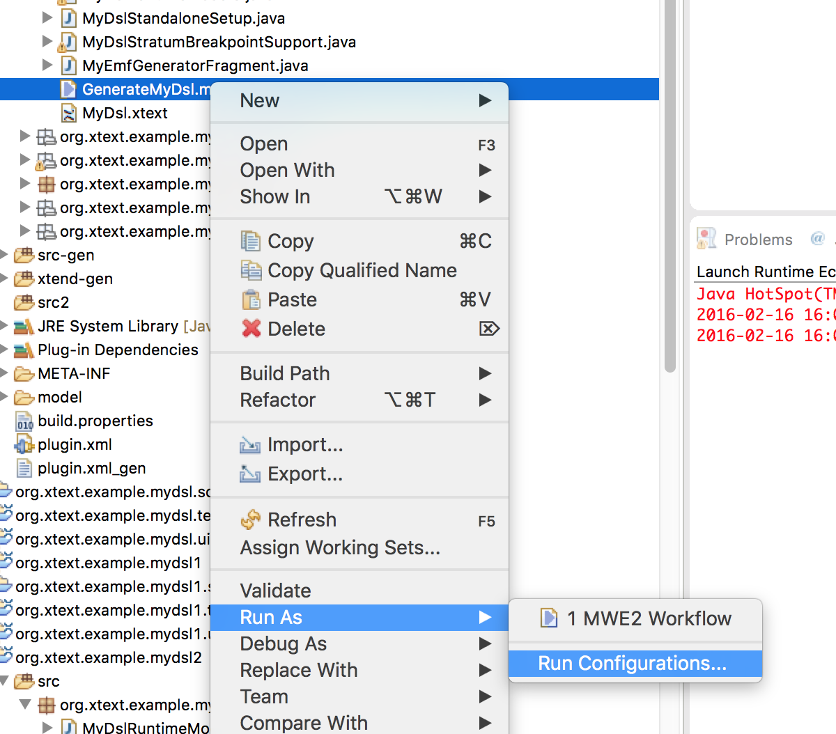

if you go to the launch config of the mwe2
you will find a -Xmx512m in Arguments/vm arguments.
increase that e.g. to -Xmx1G

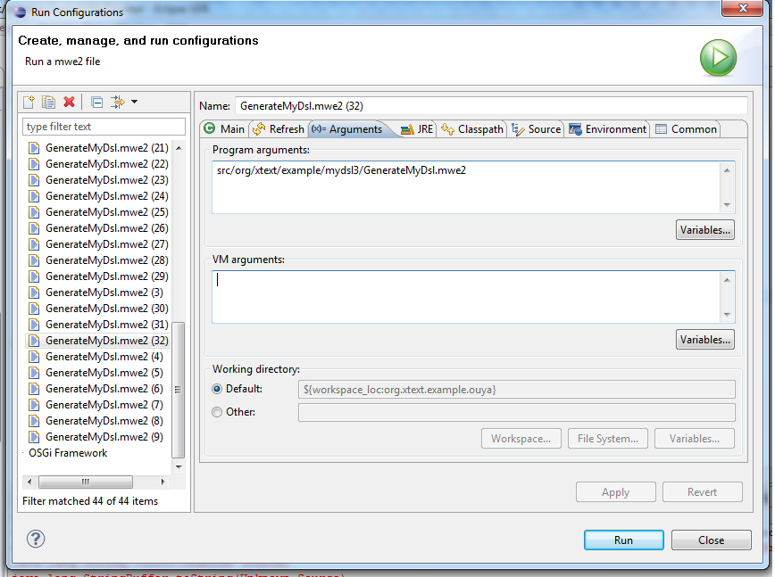

Re: Description Resource Path Location Type Bound mismatch: The generic method create(Class<T> [message #1723573 is a reply to message #1723545] Tue, 16 February 2016 11:13 Go to previous messageGo to next message
in Arguments/vm I find no argument
Re: Description Resource Path Location Type Bound mismatch: The generic method create(Class&lt;T [message #1723574 is a reply to message #1723573] Tue, 16 February 2016 11:17 Go to previous messageGo to next message

Did you go to
Run
Runconfigurations...
Select the mwe2 in the tree
Arguments tab
Can you post a screenshot of this

Re: Description Resource Path Location Type Bound mismatch: The generic method create(Class&lt;T [message #1723580 is a reply to message #1723578] Tue, 16 February 2016 11:42 Go to previous messageGo to next message
find screenshots attached
Re: Description Resource Path Location Type Bound mismatch: The generic method create(Class&lt;T [message #1723583 is a reply to message #1723580] Tue, 16 February 2016 11:47 Go to previous messageGo to next message
yes i do that in the previous message i send the image i found the Arguments/vm but it's empty

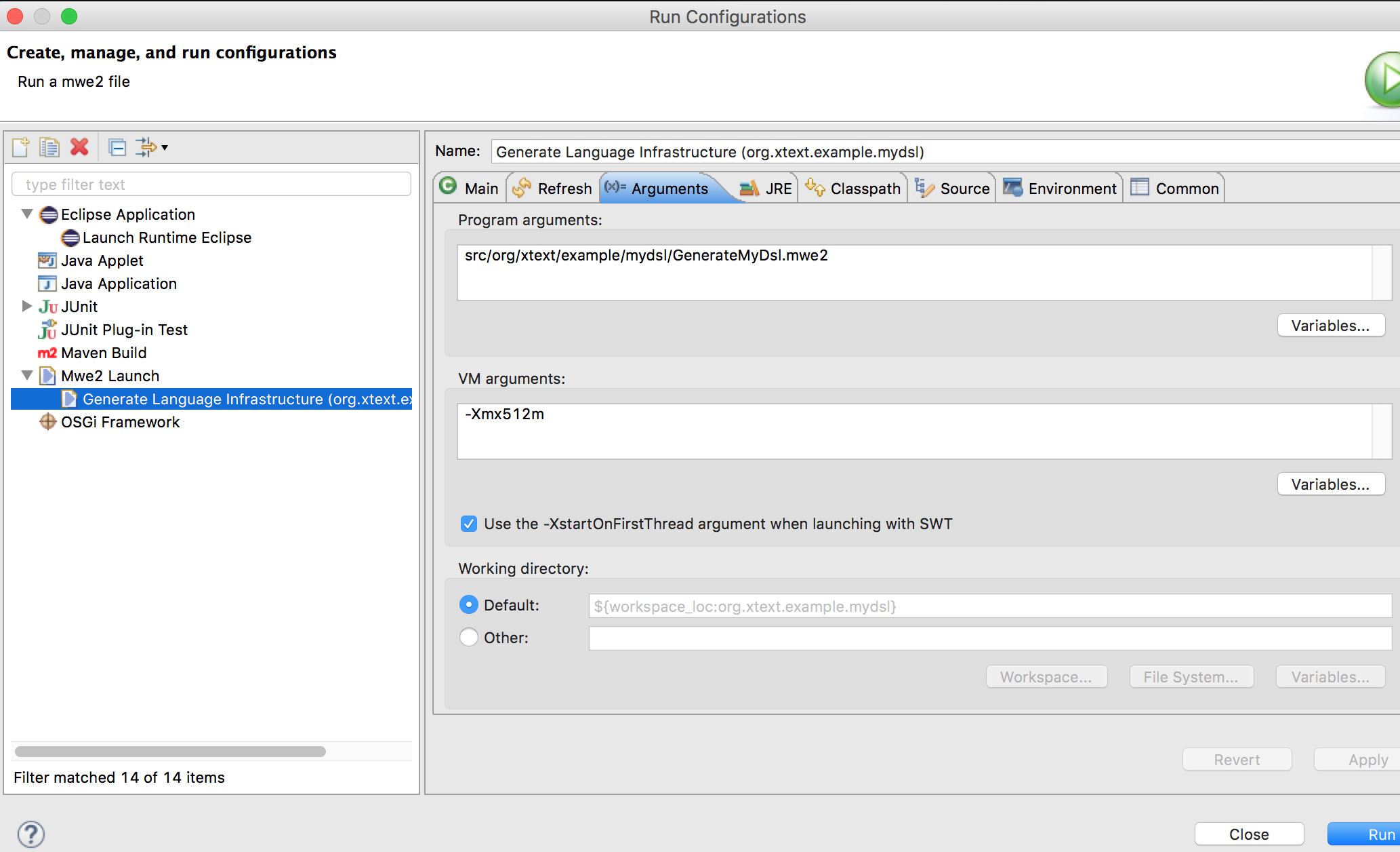

Re: Description Resource Path Location Type Bound mismatch: The generic method create(Class&lt;T [message #1723585 is a reply to message #1723583] Tue, 16 February 2016 11:51 Go to previous messageGo to next message
yes but you can type -Xmx512M or -Xmx1G
