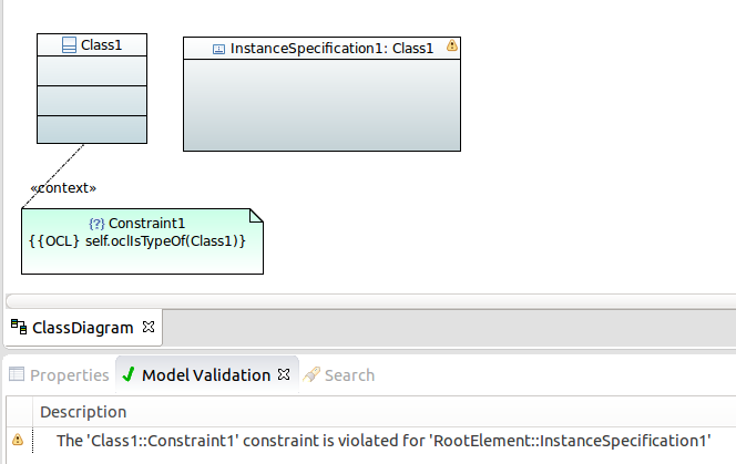

Hi All,
I cannot get my head around this.
I have created a class Class1 and an InstanceSpecification InstanceSpecfication:Class1
I have also create the following constraint for Class1:
self.oclIsTypeOf(Class1)
I was expecting it to be always verified, but when I validate the model I get that the constraint is violated.
If I replace the above OCL constraint with the following
self.oclIsTypeOf(UML:InstanceSpecification)
the model get validated

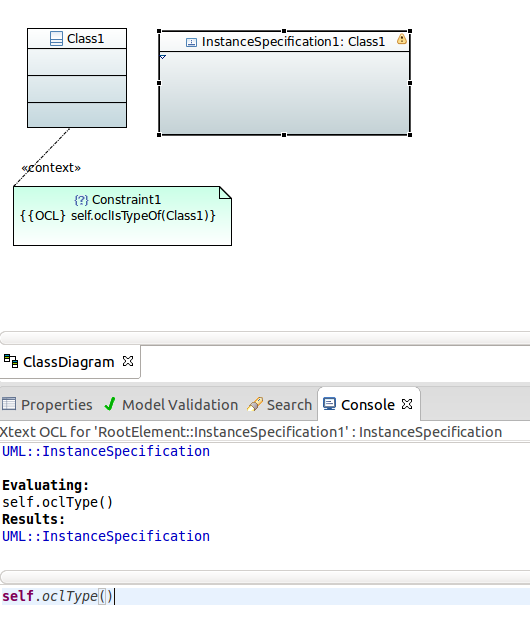

Also, If I execute the xText OCL console on InstanceSpecification1 I get
Evaluating:
self.oclType()
Results:
UML::InstanceSpecification

Re: oclIsTypeOf() does not work as expected [message #1723170 is a reply to message #1723168] Fri, 12 February 2016 05:32 Go to previous messageGo to next message
Hi Ed,
Thank your for your reply.
Here is the model that fails the validation
index.php/fa/24968/0/
OLC->Validate works on the Constraint. However, when I validate the entire model, it fails.
Roberto.
Re: oclIsTypeOf() does not work as expected [message #1723182 is a reply to message #1723170] Fri, 12 February 2016 06:30 Go to previous messageGo to next message
Also, please note the output of the OCL console
index.php/fa/24971/0/

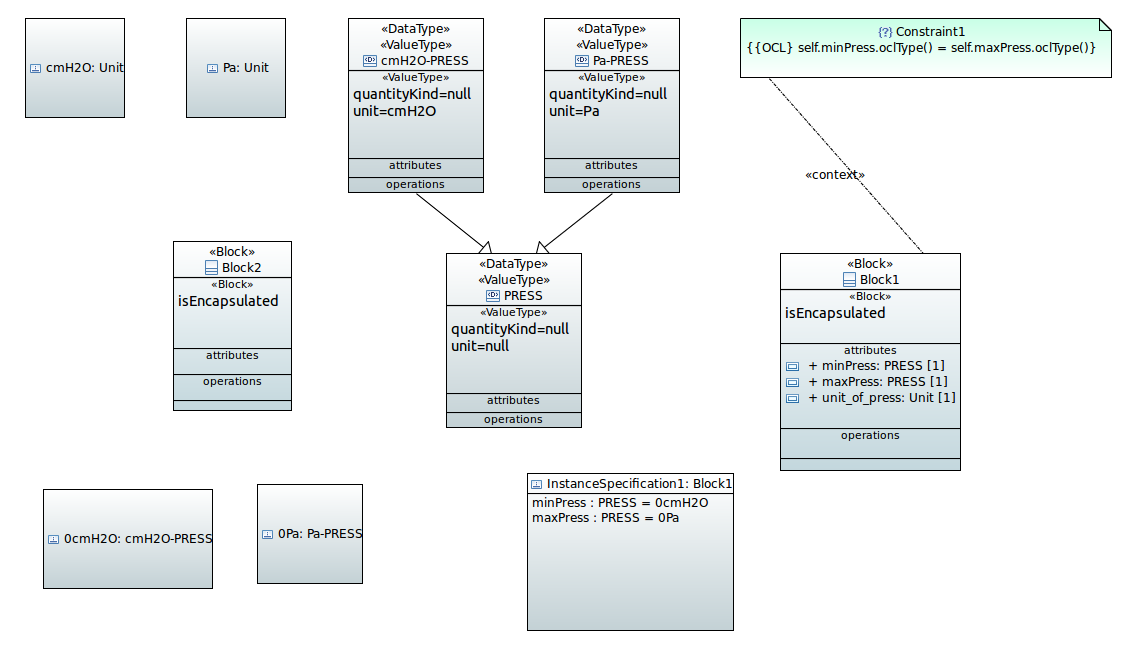

Here is one of the problem that I am trying to solve.
Considering the following diagram:
index.php/fa/24987/0/
I want to use OCL to express that the type of the instance assigned to the attribute Block1.minPress has to be the same of the instance assigned to the attribute Block1.maxPress
However, the OCL constraint that I wrote always validates the model. Whereas it should not validate the model in the example given.
Please find the sample project attached as well.
Roberto.

Re: oclIsTypeOf() does not work as expected [message #1723328 is a reply to message #1723305] Sun, 14 February 2016 07:10 Go to previous messageGo to next message
I've taken a look at the oustanding bugs in this area and refreshed my
memory a bit. It is a very awkward area.
https://bugs.eclipse.org/bugs/show_bug.cgi?id=400090
https://bugs.eclipse.org/bugs/show_bug.cgi?id=439222
https://bugs.eclipse.org/bugs/show_bug.cgi?id=458326
https://bugs.eclipse.org/bugs/show_bug.cgi?id=458394
https://bugs.eclipse.org/bugs/show_bug.cgi?id=458395
Your example helps me see what is going wrong.
OCL evaluation on an InstanceSpecification is troublesome. Should "self" be
- an instance of the UML InstanceSpecification as would be the case for
any other evaluation using a mouse selection in a UML model to identify
the context
- an instance of one or all of the InstanceSpecification::classifier
types to allow navigation in the instance world
The non-Xtext OCL console provided Ecore/UML M1/M2 behavioral options.
It seems that we need a user choice as to whether the selection's
OclType is to be computed from within the model (e.g. using
InstanceSpecification::classifier) or from the metamodel (e.g. using
EObject::eClass() or OclAny::oclType()).
A choice to use model-determined OclType could make the OCL console
useful, and extensible to other contexts in which types are no isolated
in different metamodel layers.
Back to your problem. I think you should be using compatibility of
InstanceSpecification::classifier to check for consistent usage.
Attempting to subvert oclType()/oclIsKindOf()/oclIsTypeOf() for this
purpose is unnecessary and dangerous.
The Help->Contents OCL documentation provides tutorials, with some
reference to Papyrus.
Once the OCL Console has a model-determined OclType, you will be able to
use the debug button with the OCL Console to debug your evaluations.
Ed Willink

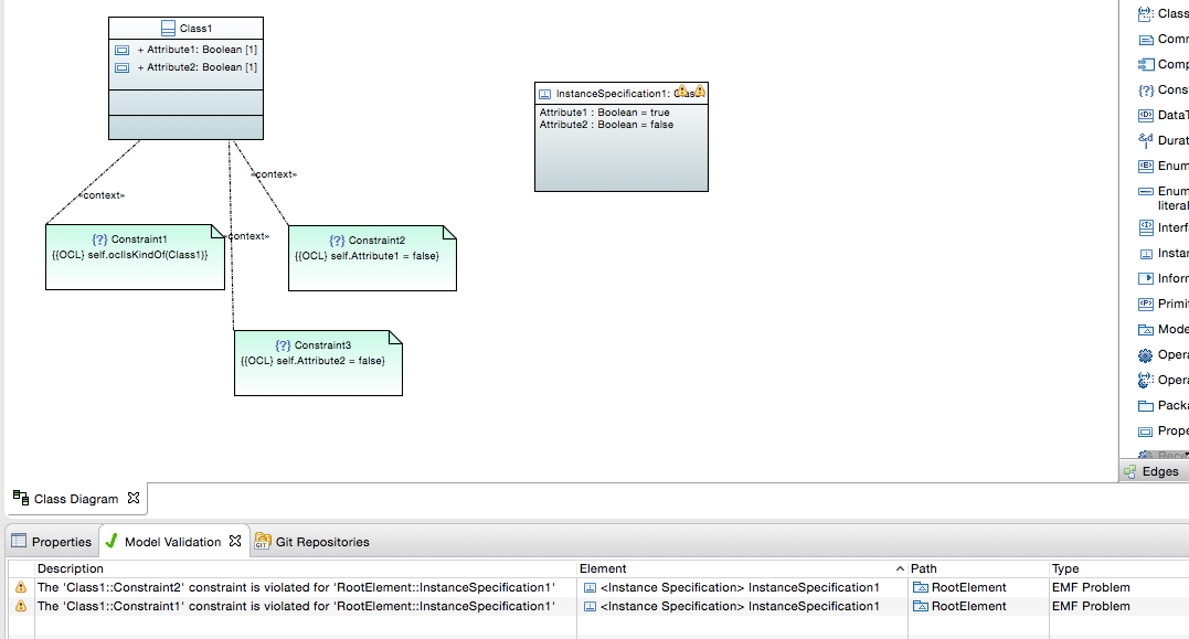

Re: oclIsTypeOf() does not work as expected [message #1723475 is a reply to message #1723395] Mon, 15 February 2016 16:23 Go to previous messageGo to next message
Hi Ed,
Thanks for your answer.
I have tried your suggestion but I was not successful.
I think that I am missing something.
So I recreated the issue by using UML only and I have attached a new project that you should be able to open with your Papyrus.
There is one conceptual thing that I think I am missing. From my understanding, all of the OCL constraint defined for a specific class in UML will be tested against InstanceSpecifications of this class only. It is only when the class in instantiated ( and I think you can do this only through an InstanceSpecification ) that the OCL constraint can be tested.
Am I missing something?
Roberto.

Re: oclIsTypeOf() does not work as expected [message #1723491 is a reply to message #1723475] Tue, 16 February 2016 02:41 Go to previous messageGo to next message
With the benefit of the Bug 400090 enhancement I can play with the
console and see that
left some InstanceValue support working with suggestions for more
testing. It seems that current functionality support the existence but
not use of the InstanceValue. Sorry.
Yes. In principle InstanceSpecification gives you an ability to mix
Classes and Instances in a single diagram, and consequently OCL
associated with Classes can be exercised on the Instances. This
functionality is not defined by OMG and so an intuitive extrapolation is
evolving. Unfortunately there is no body of useful examples and creating
them in the UML Model Editor is not easy. Creating them within Papyrus
hits other limitations. In practice this boundary has been pushed by a
couple of sympathetic users. You are pushing a bit further and providing
the example that is needed to embarrass the developer(s). Thanks.
The only workaround I can see for you today exploits toString():
Evaluating:
self.Attribute1.toString()
Results:
'org.eclipse.uml2.uml.internal.impl.InstanceSpecificationImpl@608e34bf
(name: DeriveType1Instance, visibility: <unset>)'
You can extract the type string from between "(name: " and ", visibility".
let s1 = self.Attribute1.toString(),
s1b = s1.indexOf('(name: '),
s1e = s1.indexOf(', visibility'),
s1s = s1.substring(s1b+7,s1e-1),
s2 = self.Attribute2.toString(),
s2b = s2.indexOf('(name: '),
s2e = s2.indexOf(', visibility'),
s2s = s2.substring(s2b+7,s2e-1)
in s1s = s2s
(A helper function would make this less opaque, but that is not trivial
in Papyrus.)
Ed Willink

Re: oclIsTypeOf() does not work as expected [message #1723511 is a reply to message #1723491] Tue, 16 February 2016 05:15 Go to previous messageGo to next message
Arguably we are looking at this the wrong way. Why are we trying to
evaluate a metamodel constraint at the model level?
If we stick to the metamodel level, the following works.
let a1 = self.slot->select(definingFeature.name =
'Attribute1').value->any(true).oclAsType(InstanceValue) in
let a2 = self.slot->select(definingFeature.name =
'Attribute2').value->any(true).oclAsType(InstanceValue) in
a1.instance.classifier = a2.instance.classifier
https://bugs.eclipse.org/bugs/show_bug.cgi?id=458394 suggests that if
model level evaluation is to be useful we may need a suitably overloaded
ValusSpecification::umlClassifiers() method to support use of UML's
model-level typing rater than oclType()/oclTypes() that accesses OCL's
metmodel-level typing.
Ed Willink

Hi Ed,
Thank you for your help.
Is OCL intended to be used to express meta-model constraints only? From my understanding, OCL can be used to express model constraints as well. Am I wrong?
Point 7.5,9 of the latest OCL spec, states that

Re: oclIsTypeOf() does not work as expected [message #1723690 is a reply to message #1723632] Wed, 17 February 2016 04:21 Go to previous messageGo to next message
Hi Roberto,
So it appears to me that OCL is intended to work with the model as well.
Yes, but an InstanceSpecification is not an Instance. It is at the same meta-level than the Class it is typed with.
The constraints defined in UML apply to both Class and InstanceSpecification
The constraints defined in UML Profiles apply to both Class and InstanceSpecification
The constraints defined in a specific UML Model, on a Class, apply to the instances of that Class. But UML doesn't define the instance level (It may typically be generated code)
The validation of Class' constraints on InstanceSpecifications is thus non-normative, and only a best-effort support is provided. There is a lot of confusion (and disagreement) about the notion of Instance/InstanceSpecification in UML 2
Camille
Re: oclIsTypeOf() does not work as expected [message #1723696 is a reply to message #1723632] Wed, 17 February 2016 04:36 Go to previous messageGo to next message
OCL potentially works with any technology that provides classes with
properties and operations. The philosophy of the Pivot-based Eclipse OCL
is that the external technology is normalized by conversion to the
internal pivot model. OCL works at any level, so M2 definitions in UML
profiles can be evaluated for M1 instances, and M1 declarations can
define functionality for M0 run-time evaluation.
oclType() and related operations are defined for evaluation at M(n)
using the types defined at M(n+1).
The use of InstanceSpecification creates a confusion, since nominally M1
types describing M0 instances are instantiated in a nominally M1 diagram.
For InstanceSpecifications representing nominally M0 instances at M1 we
have a choice of two type systems, the normal M2 types or the modelled
M1 types available via InstanceSpecification::classifier.
Eclipse OCL has been bending over to try to be 'helpful' by selecting
the 'more useful' of the two type systems. The flip-side of 'helpful'
code is that it is usually inconsistent and confusing.
InstanceSpecification::classifier is actually a multi-classification
which presents another challenge for OCL for which there is only one
context type. Consideration of a similar problem for SMOF concluded that
the problem goes away by introducing oclTypes() to return all possible
classifications, and requiring oclAsType(XXX) to select a current
classification when there is an ambiguity.
A similar approach can solve the InstanceSpecification ambiguity. If a
new library operation OclElement::oclAsModelType(XXX) supports
conversion to a model-defined type XXX, which may be omitted if
unambiguous, we can write your constraint more compactly as:
let this = self.oclAsModelType() in this.Attribute1.oclType() =
this.Attribute2.oclType()
The default implementation of self.oclAsModelType() should return
invalid. For UML, an InstanceSpecification overload can select from the
modelled classifiers.
I don't think we need oclModelTypes(), oclIsModelKindOf() etc as
shortforms for oclAsModelType().oclType() etc.
If my solution metamodel constraint doesn't work, then that is yet
another demonstration of how 'helpful' code is not helpful at all. I'll
investigate.
Ed Willink

Hi Roberto,
Interesting discussion you started Smile To make the problem/discussion more concrete from an end-user point-of-view (besides the interesting developers comments above), have a look at a variation of your 'original model' (see attached screenshot and example project.).
index.php/fa/25010/0/
You will probably notice that (with the "current" versions of the tooling), some things are hard to explain:
- The 'behavior' of Constraint2 and 3 probably makes sense to you (Constraint2 is reported to be violated, Constraint3 is not). This behaviour indeed 'makes sense' to everyone, but is not defined explicitly in the current specs.
- The behavior of Constraint1 didn't make sense to you (nor does it to me), and indeed it is not inline with the rest of the behaviour as currently implemented by the tooling. However, from a spec perspective, there is no problem since the spec is underdefined...
In case you have a lot of time, you might find the discussion at https://bugs.eclipse.org/bugs/show_bug.cgi?id=417062 useful Smile
On a related matter, the mission of the just started Papyrus Industrial Consortium (https://polarsys.org/wiki/Papyrus_IC) states that
The Papyrus IC is an open consortium that focuses on the development of a customizable and extensible industrial-grade open source model-based engineering tool suite based on the Papyrus/Eclipse platform, other key open source technologies, and leading industry standards (see Vision/Mission below).
I think your problem is a very concrete and useful example of where things go wrong on the last part of that sentence, and where users and developers should not put our heads into the sand and state: It's not in the spec, so we shouldn't implement this. (Shameless add: This said, you're welcome to join the consortium Smile ).
@Ed: Really appreciate the effort you put into this!

On 17/02/2016 10:39, Klaas Gadeyne wrote:
> Hi Roberto,
> Interesting discussion you started :) To make the problem/discussion more concrete from an end-user point-of-view (besides the interesting developers comments above), have a look at a variation of your 'original model' (see attached screenshot and example project.).
> In case you have a lot of time, you might find the discussion at https://bugs.eclipse.org/bugs/show_bug.cgi?id=417062 useful :)
> Quote:
> I think your problem is a very concrete and useful example of where things go wrong on the last part of that sentence, and where users and developers should not put our heads into the sand and state: It's not in the spec, so we shouldn't implement this. (Shameless add: This said, you're welcome to join the consortium :) ).

First, I have to specify that I never encountered this exact issue before myself, ie. I never came across a situation in which I added a constraint in a UML model in the context of a class, in which I used the oclIsTypeOf()/oclIsKindOf() operations. As such, I also had a closer look at the model from https://www.eclipse.org/forums/index.php?t=msg&th=1074705&goto=1723305&#msg_1723305
I found the constructs used in that model a bit 'unnatural': both cmH2O-PRESS and Pa-PRESS generalize PRESS, but in fact, they only differ in the sense that different stereotypes are applied to cmH2O-PRESS and Pa-PRESS. So I went to have a look at the SysML spec, but I didn't find a good answer in there (figure E.13 does specify the relationship between gram and kilogram, but only on a unit level, and I find no hints on what to do with the related Valuetypes in the spec [*].
However (now starts the interesting part), this particular annex of the SysML standard (QUDV) defines a model-library. As such, figure E.5 shows that the referenceUnit property points to the unit Class. As you could see in Roberto's original diagram, units in SysML models are (according to the spec) to be modeled as InstanceSpecifications. Now, have a look at constraint [1] on page 261. It states,
package QUDV
   context PrefixedUnit
   inv: not referenceUnit.oclIsTypeOf(PrefixedUnit)
   endpackage
If I interpret this correctly, this constraint does exactly the same as the one mentioned originally in this thread: i.e. it is defined in the context of a class, and it is meant to be evaluated on an instancespecification (a particular unit) . So, it seems like the spec at least implicitly acknowledges this particular form of constraint evaluation???. Moreover, looking at the rest of annex E, I wonder
  • who created the whole lot of OCL constraints present in annex E?

self.Attribute1.oclModelTypes() = self.Attribute2.oclModelTypes()
which lifts the explicit solution for an InstanceSpecification
with all its Slots and InstanceValues into the abstract world of Class
instances with Properties.
Much confusion was caused on this thread by attempting to practice the
constraint in the OCL console with an InstanceSpecification of Class1
rather than an instance of Class1 as the prevailing selection. The
solution may be practised in the console by:
let this = self.oclAsModelType(Class) in
this.Attribute1.oclModelTypes() = this.Attribute2.oclModelTypes()
When validating the Class1 constraint the evaluator knows that it is
dealing with an instance of Class1. The console does not know this and
so needs to be told. There will be a suppressable popup information
message in the Console recommending the use of an "let this =
self.oclAsModelType" wrapper whenever the selection has non-null
oclModelTypes(). No mysterious menu pull-downs.
> package QUDV
> endpackage
> wonder
> which tool he/she used to create/test these constraints (assuming it
> is impossible to do this without tool support)?
> So, to summarize my thoughts:
> From a modeling point of view, the person that specifies the OCL
> constraints, works in the context of a class, and hence the use of
> oclIsTypeOf() really makes sense, and the oclAsModelType() operation
> complicates matters. However, I repeat that I never encountered such
> a use case myself, so this might be only for specialists
> From an evaluation perspective, I understand the difficulty tool
> builders face (and hence the reason for introducing a dedicated
> operation (oclAsModelType()), yet I wonder how other toolbuilders have
> solved this (if they did).
> Do you also consider the oclAsModelType() operation as a 'workaround'
> until the OCL-evaluator is 'smart enough' to decide on the appropriate
> metalevel M1/M2 itself?
> BR,
> Klaas
