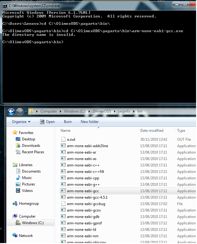

You can see the result in the attached image
  • Attachment: Untitled.png
    (Size: 128.91KB, Downloaded 562 times)
Re: /bin/sh: arm-elf-as: command not found [message #1722977 is a reply to message #1722971] Wed, 10 February 2016 10:54 Go to previous messageGo to next message
You did
cd <directory name>arm-none-eabi-gcc
. The problem with that is you ran cd (i.e. change directory) not gcc.

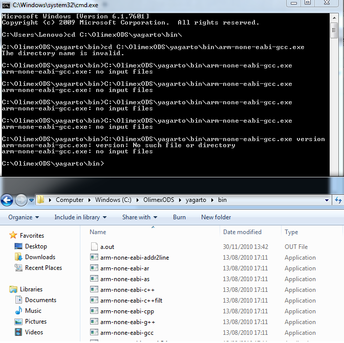

    (Size: 74.05KB, Downloaded 556 times)
Re: /bin/sh: arm-elf-as: command not found [message #1722983 is a reply to message #1722979] Wed, 10 February 2016 11:15 Go to previous message
A few comments:
1- You are still passing a full path to GCC, you said you updated the PATH so that it would work from the PATH, I am trying to have you test that by doing arm-none-eabi-gcc to see if it runs from the PATH without specifying full directory to gcc.
2- It was supposed to be --version, i.e. to get the version of gcc you are using, not very important as key thing was to see if gcc was found on the path
3- Please copy and paste console output into your message, pasting with
[code]terminal stuff here[/code]
around it to keep it fixed with font. This allows me to see the output without looking at the image and, more importantly, I can copy/paste the input/output.
