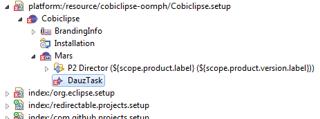

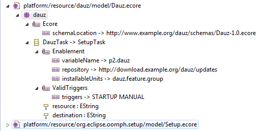

Re: Tutorial: Creating custom setuptask? [message #1723159 is a reply to message #1723064] Fri, 12 February 2016 04:20 Go to previous messageGo to next message
Thank you very much,
I've got a (hopefully) last question. How can I set the attributes of my task ? My task has two attributes that need to be set but I haven't found the right way to do so yet. I tried it with mimiking other projects and used annotations. But neither InducedChoice nor Enablement worked for me. Eclipse keeps telling me that my setup isn't valid
I included a screen of my model and my setup.
Thanks in advance
index.php/fa/24962/0/
index.php/fa/24963/0/
  • Attachment: Model.PNG
    (Size: 16.39KB, Downloaded 733 times)
  • Attachment: Setup.PNG
    (Size: 10.76KB, Downloaded 496 times)
Re: Tutorial: Creating custom setuptask? [message #1723176 is a reply to message #1723159] Fri, 12 February 2016 05:55 Go to previous messageGo to next message
Steffen,
Of course if you double click on your task, the properties view opens
and here you can set the values. Are you trying to do something beyond
that?

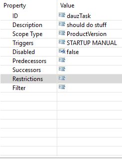

Re: Tutorial: Creating custom setuptask? [message #1723254 is a reply to message #1723176] Fri, 12 February 2016 13:27 Go to previous messageGo to next message
Ed,
I tried double clicking but all properties I can set there is an ID and a Description. Even if I open the 'advanced' properties, those I defined don't show up
Maybe I simply overlooked something but I cannot see what it is.
Thank you for your patience with me Smile
index.php/fa/24981/0/
  • Attachment: Unbenannt.JPG
    (Size: 22.10KB, Downloaded 498 times)
Re: Tutorial: Creating custom setuptask? [message #1723274 is a reply to message #1723254] Sat, 13 February 2016 02:33 Go to previous messageGo to next message
Steffen,
In this context, is your generated model installed? I suppose so,
because your schemaLocation value looks like a dummy value. In the
generated DauzItemProvider, is there an addResourcePropertyDescriptor
method? If not, your GenFeatures for these features probably probably
specifies None for Property Type.
On 12.02.2016 19:27, Steffen Holzer wrote:
> Ed,
> Thank you for your patience with me :)
Re: Tutorial: Creating custom setuptask? [message #1723283 is a reply to message #1723274] Sat, 13 February 2016 05:34 Go to previous message
Ed,
Thank you. That did it. Maybe the problem was also that I only executed the "generate model code" and forgot the "generate edit code"
Thanks for your help Smile
