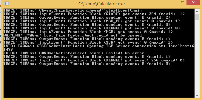

I am getting WSA Error 10013 when running forte on windows 8. I got the error code by printing out the return value WSAGetLastError(). Additionally, I figured that only some ports like 61499, 61500, 61501 give this error. If I run forte on a port like 60000, 20000, the sockets are successfully created. I have also used the netsh show command to see if there was an exclusive right on the ports above, but there was no exception for the ports above. Previously I was able to solve this problem by just restarting the computer, but now I can't even do that.
Does someone know about this problem?
Attached image of the error. It says no error, but the error is really 10013 which I got by debugging forte.
Thank you.

Hi, Thank you for the response. I have tried turning both the firewall and anti-virus (including windows defender) software off, but the problem seems to be something else. There was a discussion on the some ports being marked as exclusive for other programs, but this does not seem to be the case either. I have also tried booting in safe mode, but that does not help either. Anyway, at least it seems like a problem on just my pc (if not windows 8 ). And how tragic for one of the bad ports to be 61499...
