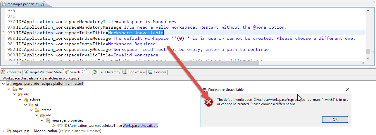

I performed a search in the source code for the Title of the window, and I found title and message are defined in the "message.properties" of the "org.eclipse.ui.ide" project
So, I think the easy way is just to edit the text in the message.properties . See image below
index.php/fa/24912/0/
Patrik

thanks for your fast answer.
This is unfortunately not the messages, i am talking about. In out pure E4 application, the mentioned plugin is not even existing within out Target Platform.
Its more a "Workspace can not b locked" messages etc pp
Stefan

I am sure it is possible, but I can't search your source code. You have to find yourself the class responsible for the message, intercept the dialog open and change the message text.
IIUC this is a startup dialog - If so you can not use the Eclipse Spies to find the responsible class.
So my suggestion is to do the same I did: search for the exact string in source code, find the plugin responsible for this, and edit the plugin source.
